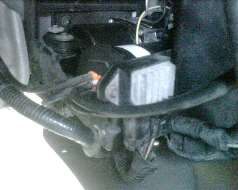

Can anyone locate the relay in this picture. Can't seem to find it. I just replaced the compressor and a day later the relay is gone...
That square thing with the metal fins and the connector going into it.
yes you have to take the screws out.. I believe an 8mm socket will work
Thanks, got it out and replaced it with the ABS relay until I can get another one. Thank God it was not something else. I have already spent $500 this month because of the starter motor and the air compressor decided to go out.
try putting the air ride relay back on the abs
the air ride puts alot more load on the relay than the abs does
on my 95, the air ride relay wouldn't work the air ride but it did work well enough for the abs system
