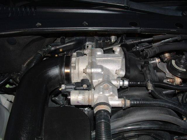

I will give you the suggestion that was given to me - take the two bolts off of the IAC and clean the IAC, but be careful of the sensor. There is a round disc in there that sometimes sticks open.
See if this helps...
