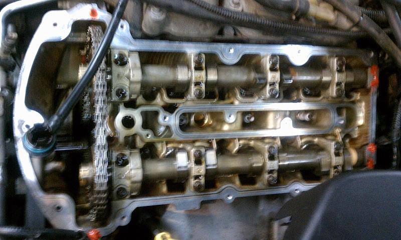

It may also make sense to change at least your passenger side valve cover gasket while you are in there. If there is any sign of oil in the spark plugs area, change the gasket while you have the intake off. You can spend up to 5 hours in this job, or as little as 2, depending on how slow, clean, and careful you are. I am planning a 6 hour block when i do mine next week, but i don't care if i take too long. There is too much at stake with a valve cover off to rush. Taking off a valve cover puts dirt way too close to the cams and valve train.
