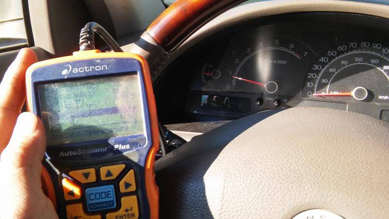

I recently bought a 2005 lincoln ls everything checked out except for one thing..It stays around 225°F.Doesnt overheat but thats pretty high to me.I changed thermostat to 180°F, but no change..It does go down to 192~199 with ac on.So my question is what is considered normal temp specs???
Heres a pic
I don't know if I want to go into this again. The last time someone asked what temperature the car was supposed to run, I told him and then he assured me that I was wrong.
Your LS is in fact overheating. (Overheating starts before the gauge passes the halfway mark.) You can take the thermostat out completely, and it will still be overheating. You need to put the correct (190 or so) thermostat back in and then fix the cooling system problem(s).
