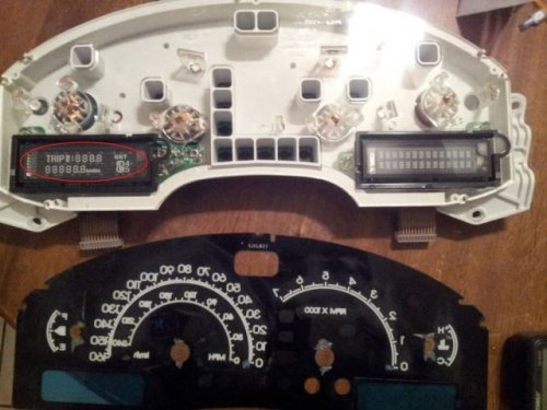

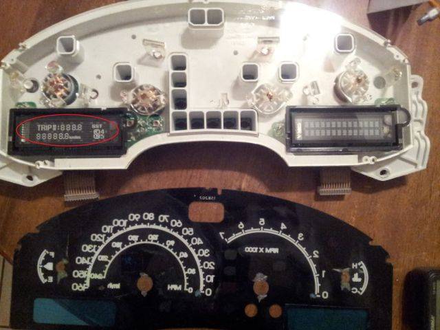

adrst2.3 question for ya!
this thingy here circled in red,

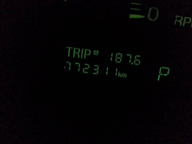

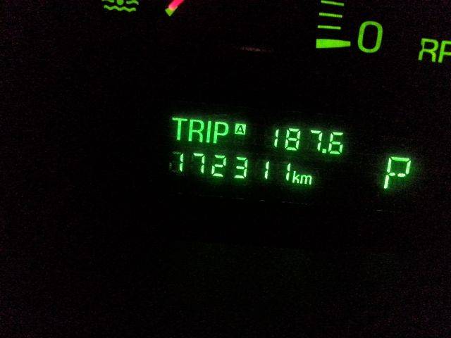

see what mine does,
when I dim it all the way down?
The first digit has a defect and turns into a 7.
but only when dimmed down (which is how I usually like to roll)
That thingy sits in a seated connector and just pops out ... or is SMT soldered to the board?
I see 1st GEN clusters at the yards and was thinking of smash and grab one of those thingy's to replace mine with.
foresee any problems ?
TIA
Looks like your display needs new solder reflowed to the pins of that bad boy
It is soldered to the board huh?
Thought it looked like it was seated in a connector. Too bad.
Well if it's seatded to a connector you can try pulling the display out (carefully) then pushing the contact pins in the connector toward the inside so the display pins have a tighter fit also reflow solder to the connector pins
Hmmm interesting, that first pic is one of yours of a cluster you have open.
I do not have my cluster open at this time, I was asking if you knew if it was soldered to the board or seated in it's own connector.
you don't think I could just pop a replacement display onto the connector and be done with it.
it seriously would require reflowing of the connections from the board huh?
~ not that such would be a problem for me, took some 50 & 100mil spec SMT certified soldering courses
for reflow when I worked for DIGITAL EQUIPMENT back in the days.
Really was just hoping I'd just pop a new display in and be done with it. (kinda like how I thought I'd just win the lotto the other day also but NO!)
Thanks much!
Yes you can replace it but try reflowing solder to connector pins and yes it is removable since there is a connector that the display sits on
