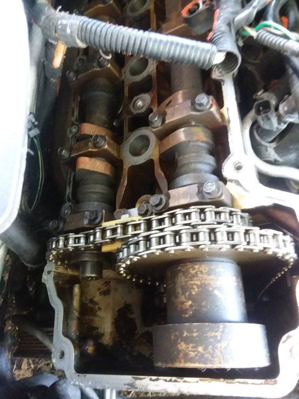

    I honestly don't even know where to begin. Three years ago, my mother, in her infinite wisdom, bought an 01 LS from a shady Hispanic gent with 150ish thousand on the odometer. 3.9 liter, as you can expect. Problems came to bare it's teeth immediately. O2 sensors went bad, replaced them, car overheated and spat out antifreeze. Fixed that, (and I should add, and you all are gonna cringe, she ran 87 octane every single time. Not once 91 or up.) and kept on driving. Next the car overheated two more times, managing to somehow keep the block from cracking. Then the all too infamous timing chain tensioners failing. Now, instead of being smart, she kept driving it. I'm talking, "Hey, let's get on the highway and floor it," driving. She parked it nine months ago, and said it's mine if I piece it together. I tore the front of the engine apart, replaced both tensioners on both sides, as well as replacing all four timing chains. I know I'm running the risk of a trashed engine, but hey. I have access to the cams right now, I'll update with pictures later to help you get a better grasp of my situation.
    I'm getting conflicting answers on where the cam timing marks need to be, and whether they have to match on the left and right side. I've educated myself well on the car, and this is where I'm stumped.
    The closest I've come to for answers is the 4.0 Jag V8, and I am NOT trusting that as a source. I'd be insane to. Any help would be appreciated, and I'll work along as best as I can.

    There is a tool to hold the flats of the cams in the correct position, and another tool to hold the crank in the correct position. The flats on both sides (all four cams) have to be correct, as well as the crank, all at the same time.
    This thread may help: Timing Chain Teardown Time
    You could also try searching this site...

    If you get to the point where you find the engine is thrashed, if the rest of the car is nice you can get a put a May 2001 or 2002 built used engine that has the updated chains and oil pump and swap that in and your car will run for a long time.
    For others that are browsing, this is probably the go to answer for gen 1 cars now instead of dealing with timing chains. I learned this the hard/expensive way.

      I've been digging, I have an O'Reilly's that has the tools to lock the cams and crank, so that's a start. I'm almost tempted to rip the cams out and just see if my efforts are worth it or not

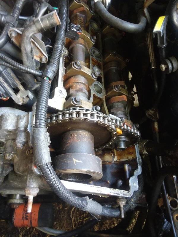

      And I see the second photo refused to send. Lovely.
    • embe

    • joegr

      Yeah, I think that just seeing how dry all that is would be enough for me to give up on that engine. It had a very rough life, maybe it's time to let it Rest In Peace.

      She's been through this much, if the cams prove to be bad, I've got access to another four. The cams condition don't scare me, what scares me is if I have to dig down past the cams.

      And yeah, she's rough. I'm going to heavily live them to give em a fighting chance.

        So, I can tell by that big nob paperweight on the front of you cams that you have a pre may 2001 engine. Getting back to my 2 cents, you are definitely in the boat of it is less work to pull and put in a 2002 engine than to do the chains right on that engine. You see, the issue is the oil pump at the bottom wasn't designed to really lube the chain system. They ended up putting 2 nozzles on the pump to squirt oil directly on the chains.
        That's why the issues and the extensive change. Assuming loving care and tenderness, the chains would make it some time and not break. Mine had a minor rattle but my mechanic didn't like how worn the sprocket teeth were with only 100k miles so we redid the whole thing. I got the car second hand from an 80+ old couple WITH all routine receipts for maintenance - so it had optimal love.
        As you have said, no love for this one so it might be wise to go the pull and replace route. BTW those to big nobbers go away in the later versions. Just gone in the 2002, and some different mechanism with the VVT in gen 2.
