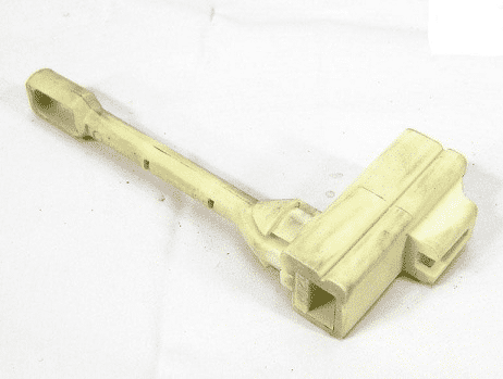

This is what is keeping the AC compressor off. It could be the wiring, but it is probably the sensor itself. Fortunately, it is only $30 or so. If it is the sensor, you can unplug it, and the AC should go back to working. (Without the sensor, it can freeze up at times, so you do want to replace it.)
This may help you find it. It's under the dash, driver's side toward the middle, part way up.
Only the connector part of it will be visible.

It's possible that you have a short in the wiring, but it is even more possible that you disconnected the wrong sensor. There are three of them that use the same part, the evap temperature sensor, the driver's side outlet temperature sensor, and the passenger side outlet temperature sensor. The two side sensors are located fairly low down on each side. If you check the passenger side and there is a sensor there at the same level as the one you disconnected, you pulled the wrong sensor. Look up higher on the driver's side for the evap temperature sensor.
I accessed the part from underneath the steering wheel. I yanked off the kick cover and the plastic that covers the foot pedals. I saw one sensor really low close to the cigarette lighter, and one up about halfway up the center console sticking out the side. I disconnected the higher one. Couldn't see one higher up than that
That should be the correct one. Time to check the wiring.
FIXED IT!! So I just replaced the evap temp sensor with another one I found at the junkyard. I picked up a few just in case.. all in way better condition than what mine was. For some reason it wouldn't work without the sensor being unplugged. I guess in this case it had to be plugged into a working sensor? Either way, she's back! And working lol. Until next issue... Great cars, just have little issues here and there.
