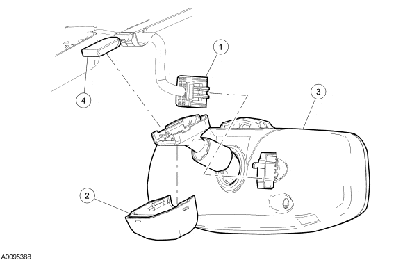

Is it possible to remove only the mirror but not the pivoting arm?
Thx
Edit:
The E/C Mirror was leaking some kind of chemical so I kind of had to rip it off lol..
Pryed the seam and the mirror broke coming off but found the bolt hidden behind
Just so the next person doesn't needlessly break things...
Interior Rear View Mirror
Printable View (75 KB)​
Special Tool(s)
Installer, Rear View Mirror
501-025 (T94P-17700-AH)
Material
ItemSpecification
Rear View Mirror Adhesive
TA-17
ItemPart NumberDescription
114A464Interior rear view mirror electrical connector
2Interior rear view mirror cover (part of 17E678)
317700Interior rear view mirror
417698Interior rear view mirror button
Removal
  1. Disconnect the interior rear view mirror electrical connector.
  1. Remove the interior rear view mirror cover.
  1. Place the interior rear view mirror in the full DOWN position. Pull upward until released.
Installation
  1. Place the interior rear view mirror on the windshield bracket. Using the special tool, press the mirror in place until fully seated.
  1. Install the interior rear view mirror cover.
  1. Connect the interior rear view mirror electrical connector.
