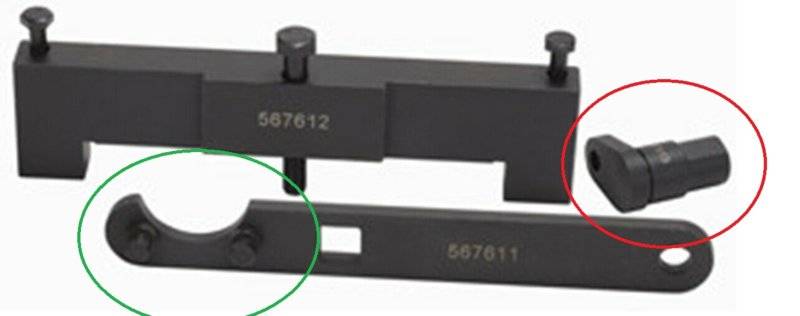

    ive seen a vid for later models to do a phaser lockout with a chain wedge also I just remember something about putting a pin in place to maintain the timing and I hanvnt found the link again putting a drill bit of the right size in a hole what is the red one and what is the green one
    thanks nothing heavy yet locking up the cams enough ...after I take off the chains and remove the head something better than just at 6 oclock ?

    The shop manual (above Deneau link) gives the part numbers. Duh...
    303-530 = cam aligner
    303-532 = cam tensioner tool
    303-645 = flywheel/flex plate lock/crank aligner
