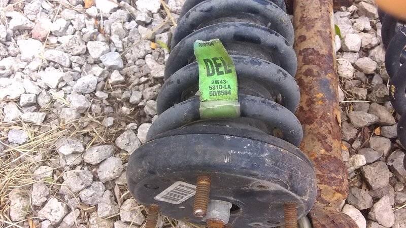

There is typically a colored tag on the spring with the part number.
The tag could be green, yellow, orange, white, or purple... IIRC.

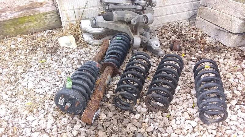

Thing is... you could have "orange" springs on the front... and green springs on the rear. Or green springs on front... and yellow springs on the rear. Or yellow springs on the front..
and orange springs on the rear.
The bad/confusing thing is... that the front orang springs are different from the rear orange springs. Same with the yellow... or any other color.
They pretty much used the whole color of the rainbow... except for black.
W,R,O,Y,G,B,P
Complete original green front shock assemblies from my 04 Sport package. Rear are green too.
No longer available IIRC.
Yellow spring, (far right), came from the rear of a Gen 1 V6 LSE IIRC. Don't know what was on the front. I had some orange springs around here at one time.
Here's what they are talking about. The dealer/Ford... needs the color of the tag on your factory springs... and the part number on the tag.
Rear springs depend on the suspension package... and the front springs depend on the engine AND the suspension package.
