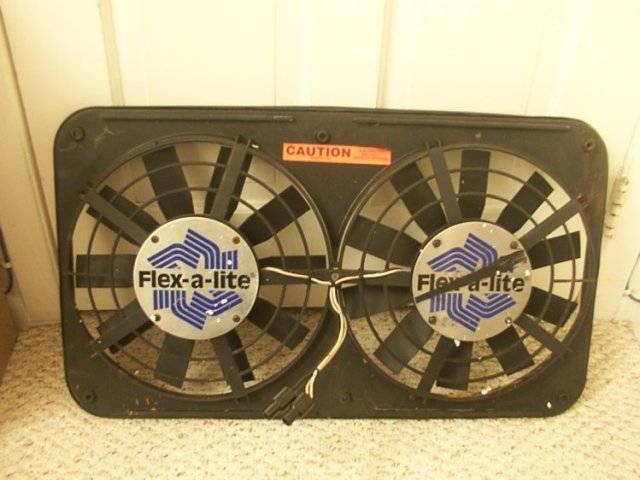

They're dual Flex-A-Lite fans. I got them off someone on FvC about 2.5 years ago. The picture of them on is from back then. The wiring's been changed and there's brackets holding it onto the radiator. And that's before I removed the AC compressor, too. lol
And yeah, I think the stock radiator is a 2 row.

NYC LSC - Those fans looks good. I should have went with a double. Do you know the make (Vehical) your fans were made for?
