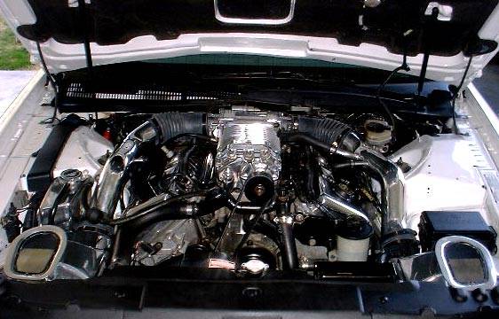

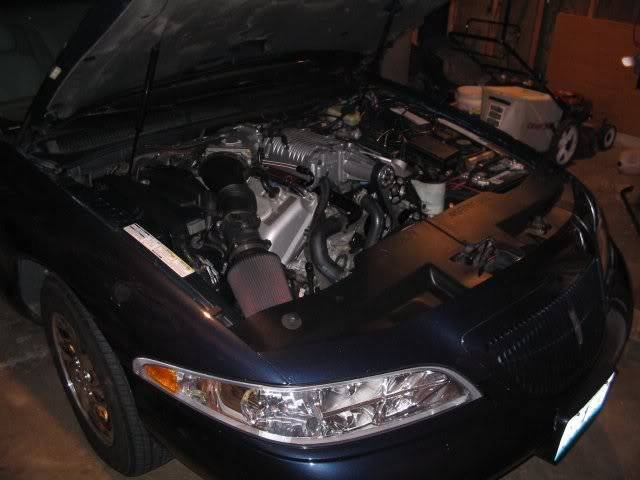

Here is an eaton with a 04 cobra intake tube
Damn how the motor looks different now from back then

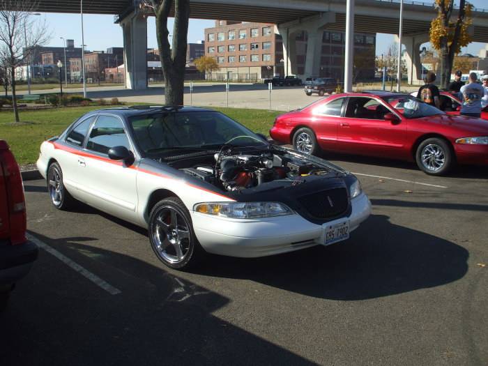

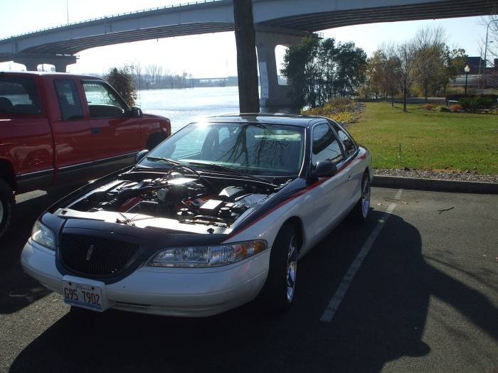

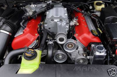

Well poopies. That KB blown two tone Mark does not have a hood and it looks like its because the dangded blower wont clear. :( That worries me.

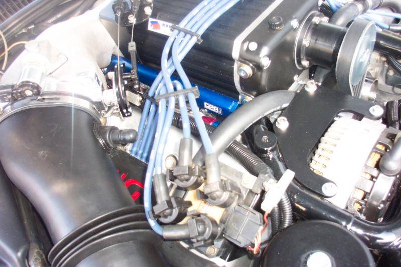

Phreaky, that car looks like pure sex mang! So I see the IAC is no longer in its stock location. Where is it or did you tune around it?

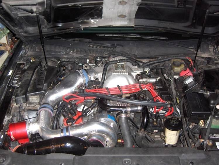

My KB was also on B-series heads. It fit under the hood, you can see in the vortech pic where I modified the hood to clear the KB. I also modified a PowerPipe that was designed for a 03-04 Cobra.

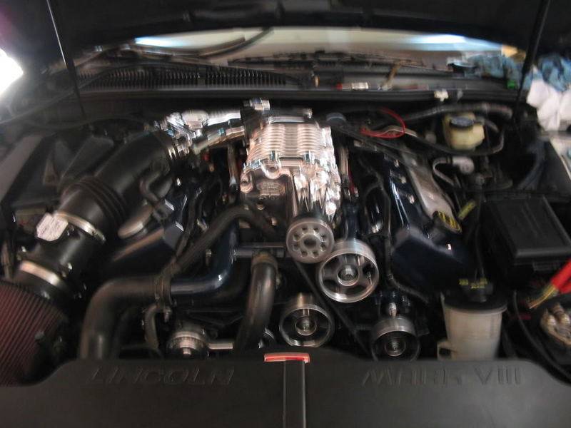

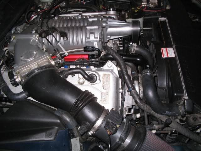

I guess I can let the 'secret' out. I did an EGR delete and I made an adapter to bolt a 99-04 mustang gt IAC to the old EGR port on the back of the blower, extended the wires, and ran a hose post MAF, pre throtle body to the intake port of the IAC, put in threaded studs, modified the IAC a little for fitment and RTV that sucker just in case. Its sorta ugly thats why I haven't taken any pictures of it. once I find someone that can do some simple CNC work I'll have something milled out prettier. I may do it by hand, just ALOT of work, I have about 10 prototypes that all are junk and the one I have barely fits.
thats lcs8's car maybe you should hit him up, he said it wont fit cuz of the throttle cable bracket and was working on something

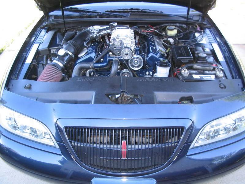

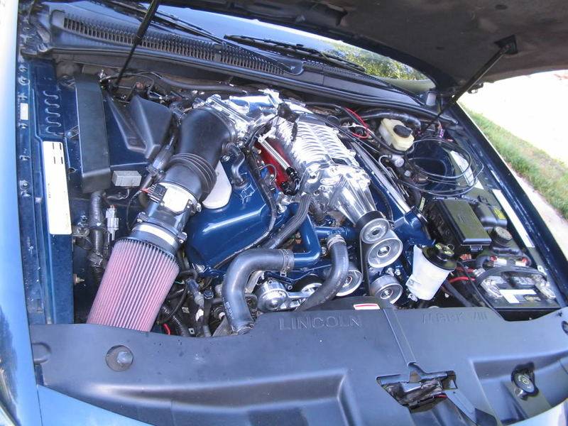

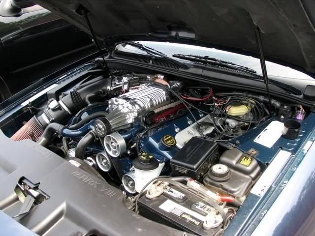

Here is some
Thanks! I notice yours has a different throttle cable mount and the alt is turned around as well as a different crossover tube. Whats up with that?

Clearance wise the Gen 2 already had a nice bubble for an SC that obviously never happened.
If you have an issue at all I would suspect it being the back webbing.
See the SuperMark's webbing has been "notched" thats the only thing I could see giving you trouble?
It's TB is mounted that way, and the cable mount came from KB, as well as the bracket to turn the alternator around. This is the tuner kit for 1999 and up and also has the liquid inter cooler. There is also a set of idle rollers just below the SC snout that pinch the belt inward for additional tension to prevent slippage (wraps the pulley to almost 270 degrees of contact). This in conjunction with the steel belt tensioner has eliminated any kind of slippage.
