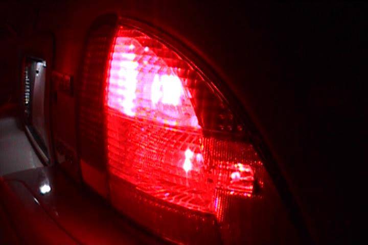

I have all RED TAILS so turn signal and brake LED lights must be RED.
Rear Turn signal LEDs: V-LEDS RED 60 M-SMT TAIL/BRAKE LIGHT BULBS 3157 3156

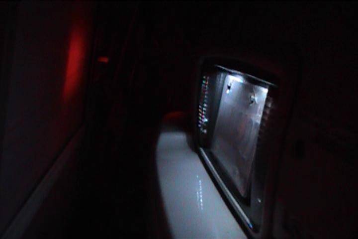

Rear License Plate lights:
168s > 2 HID WHITE SMT 5 LED LIGHT BULBS 194 168 158 2821

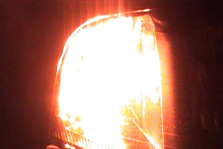

Front Turn signals are AMBER:
3157 - 2 AMBER SMT 27 LED PARKING/TURN/BLINKER BULBS 3157 3156

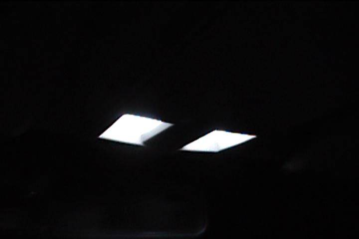

Interior have all been changed over to white LEDs (Front and back Dome/Maps - Driver side and passenger side floor) Lights:
194s-168s > 2 HID WHITE SMT 5 LED LIGHT BULBS 194 168 158 2821

Only $10 bucks and has a picture on how to hook them up. Like I said I have these hooked up to front amber signals only in my headlights and they work nice. However the turnsignals function fine but do not turn on when I have my headlights on. Which that doesn't bother me. It actually looks sweet when I only have my fogs on as there is a orange glow from the two sidemarker amber LEDs that came factory with the car. I will show this in my uploaded pictures tonight and in my YOUTUBE video.

Pictures and Video ADDED!!!
Here are some pictures of the LED lights and a video for viewing....

the video is cool. what license plate led's did you go with? i got the ones Ken has but i would've liked a bluer color to match my interior ones but after a while i just decided to keep them.
