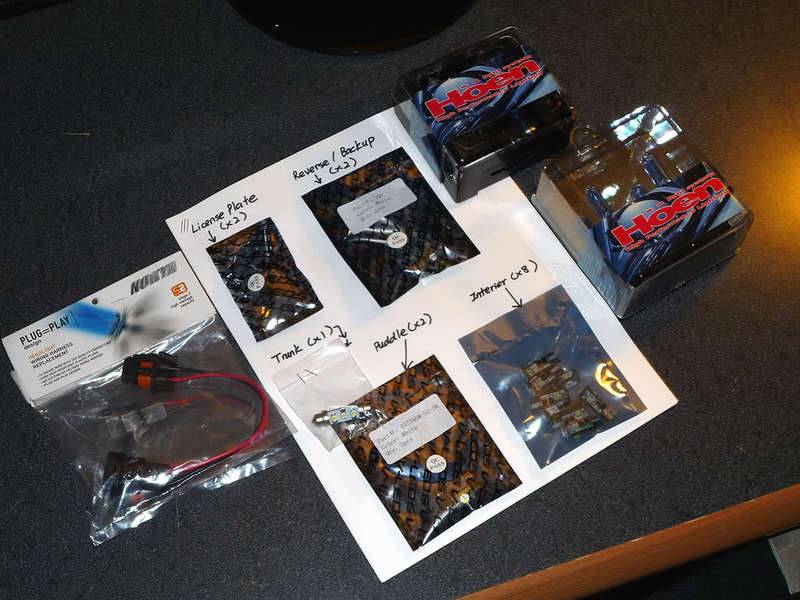

Will be doing this over the weekend :
Looking forward seeing the pics of them installed.
