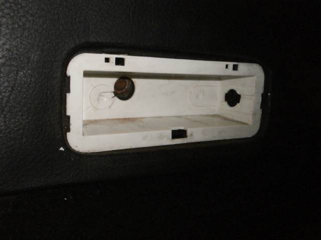

replacing inside lights (168's) with LED's...this bulb socket came out of the plastic box at the bottom of the driver door...anyone know how to get that box out to reset the socket without breaking the plastic?
also, I've tried two bulbs so far (driver door bottom and 1of2 overhead reading)...neither one works...wth?

Remove the door panel
They don't look like the right bulbs, do your originals work in the sockets you tried?
shameless question I need a quick answer on...how do I remove the drv door panel? last time I did that was about 6 years ago when the pwr window sw lost the auto down function
Two screws. One down at the courtesy light at the bottom of the door, the other behind an access panel (think it's the one by the armrest, I forget). Helps to also remove that wedge-shaped trim piece at the very front of the window. Door panel comes straight up, it's hooked in with these plastic hooks that are really easy to break (ask me how I know).
EDIT: Oh yeah, and the trim piece around the door latch gotta come off too, and pop the window button panel loose; it's gotta be able to turn to come through its hole in the door panel.
In your pic above, there's a rusty screw, remove that. Then remove the one behind the inner handle bezel. Remove the bezel by sliding a flat tip screw driver behind the lower rear corner of it and lift outward slightly and repeat the same on the front lower corner. Pull handle and remove bezel. Remove window button panel and unplug it. Remove the triangle cover for the rear view mirror.
On a Gen 1 there is a bolt behind the hand grip .. I dunno the easy way to remove it, every Gen 1 I've had , the plastic was broken right there from someone else removing the panel the wrong way.
Once you've got the screws out and the bolt, lift the panel from the bottom and it'll pop loose
