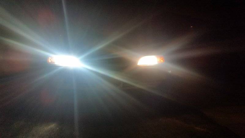

1st pic shows digital box installed with Velcro (similar to ballast box w/HID kit)
2nd pic show complete install with factory harness inside housing
3rd pic shows the difference between stock and LED bulbs installed.
4th is stock HID's
5th is stock HID's with new LED high beams
