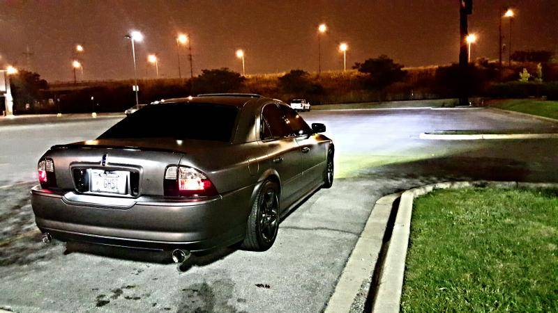

I have a led kit in my low beams and fogs , my lows are from Vleds and they are amazing , my fogs are from nokya

Those are cheap off brand ones , vleds are top of the food chain leds , 4500 lumens each ( 9000 total ) , amazing build quality and light output , have had mine for a year already and the fan does stick out but it hasnt failed on me and its subzero outside here in Chicago
