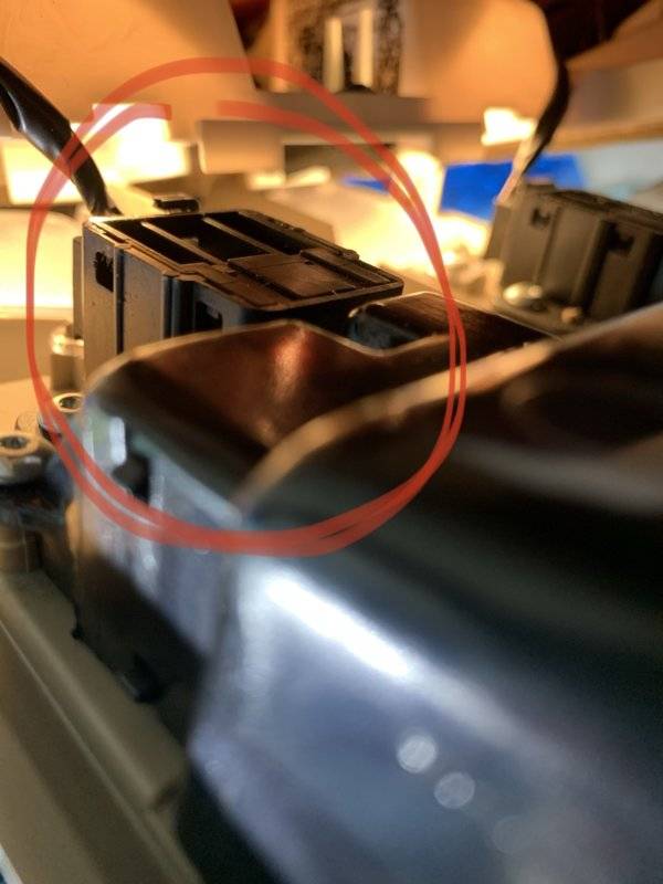

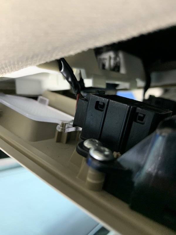

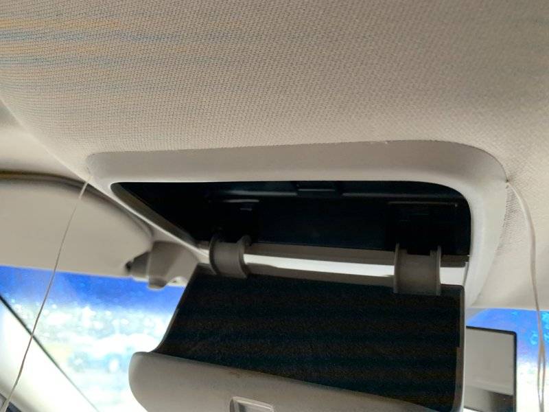

      I’m having a hard time disconnecting the wires from the dome light so I can remove the plastic piece from the headliner and have better access to the bulbs. How do these connectors release? Already broke off a little piece of plastic. I can’t really see what I’m working with here.

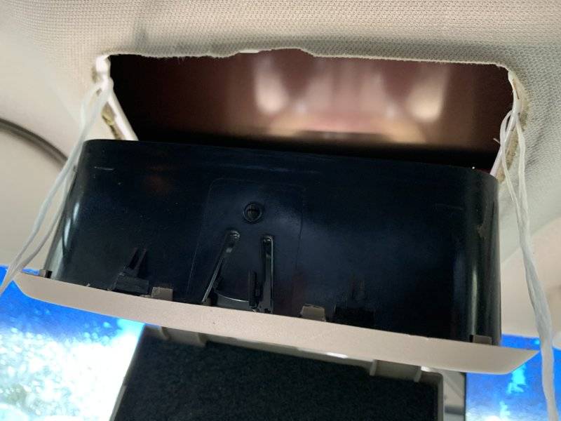

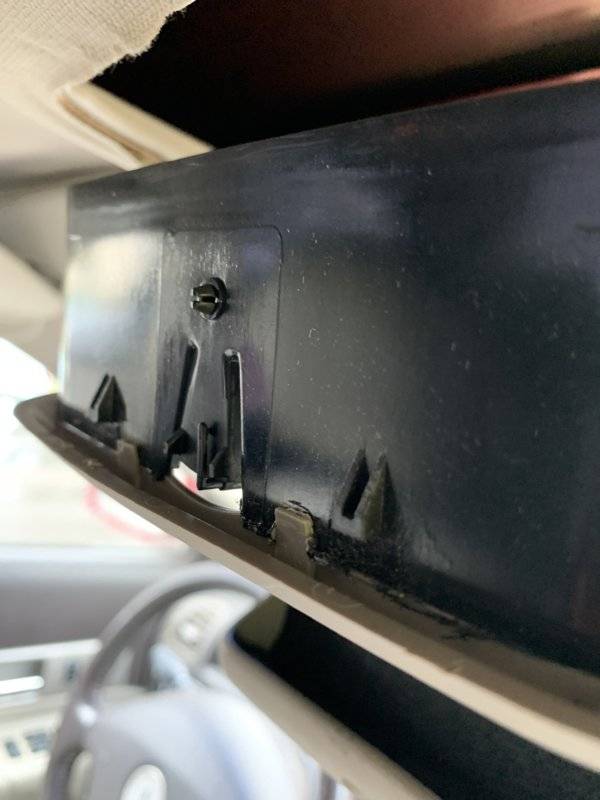

      Nevermind. I got em. Now my problem is the thing won’t go back in flush. The plastic rim that it clips into in the back seems to move up when i push the back in so the clips can’t grab it. Any pointers here?

      If you have the moon roof, then open it and use a large flat blade screw driver to push down on the plastic ring while you push up on the doom light. If you don't have a moon roof, then I guess you'd have to glue the plastic ring down really well and try to snap the light fixture in a day or two later.

        No moon roof. Ended up MacGuyvering it. Drilled two tiny holes in either side of the plastic ring and ran some (waxed) dental floss through them. Then I pulled down on the floss as I pushed the unit back in, which allowed the tabs to click back into place. Then I gently pulled the floss out.

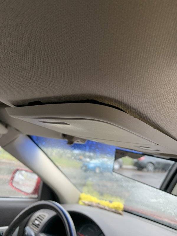

            I have the same thing with the LED in the trunk. Put one of your seats down and you will probably see it too.
            I also have the glasses compartment trim piece hanging down. I will try the moonroof trick that Joegr suggested. It would be nice to get that flush since it does bug me quite a bit.

            Yes back by the 3rd brake light as well as more forward by the moonroof. The sticky goo that holds the velcro failed and I really don't want to try to clean it all off before I try to re-glue them. I was thinking of some lines of silicone and bracing the liner till it dried. Have had some success using silicone for different things before. Maybe it will hold the headliner.

            Follow up. I used some 100% silicone to glue the glasses trim piece that was hanging down. I put a dab in both corners only and it has held for months now. I also recently did the headliner with big globs of silicone in the velcro locations and that has held for a couple of weeks now too. Vinegar smell goes away after a few days.
