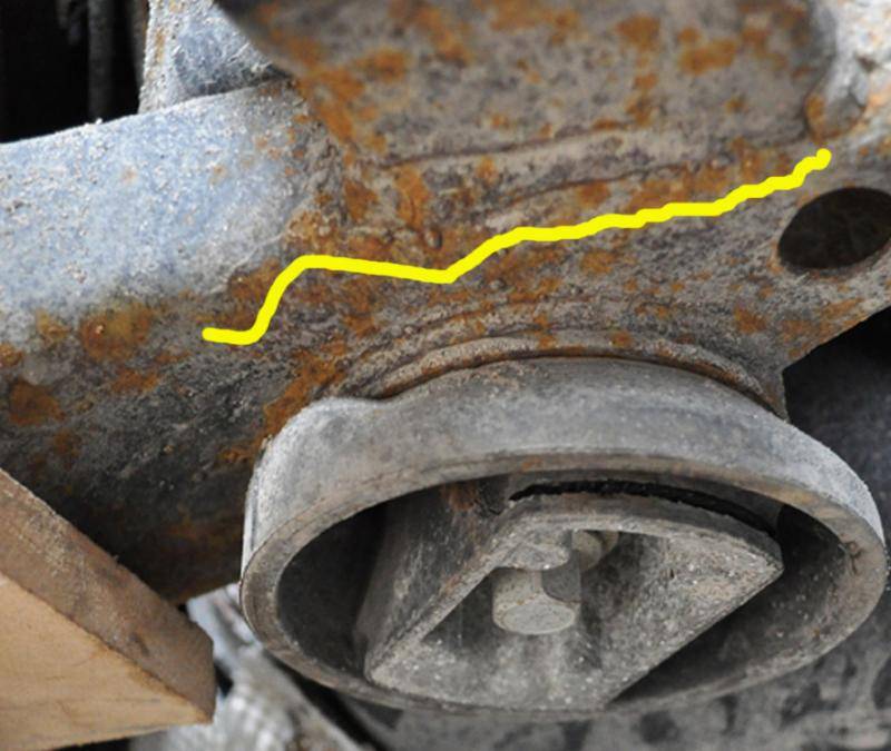

I also discovered a cracked subframe bushing, which I believe is the cause of the popping noise I've been hearing lately during low speed turns and on uneven surfaces. I think it fits the pattern.

I used those as jack points on all my LSes. The edges of some are cracked and I have yet to hear anything from them in over 10 years.
I wouldn't worry too much about the bushing.
I would worry a little more about what appears to be a crack propagating out of the weldment above it, just above my yellow line. Might want to take a wire brush to that and see if it is a crack.

Must be the climate? I rarely push the car hard, nor have I ever jacked it up by the bushing. So much for babying it during my ownership..
Thanks for the heads up, Jack! I cleaned up the area you pointed out, and it appears to be a deep scratch of some sort (at this point anyway).
So this bushing, being cracked and that it creates popping noise during turning and on uneven surfaces - does it affect the safety of the vehicle? I was hoping to keep it for at least 2 more years.

The bushing is a rubber mount, not that metal piece. Looks like #8 in the picture. Not listed???????
Not sold separately, have to buy the entire subframe. I believe it's metal but covered with rubber - hitting it with a hammer produces a metal resonance. Same with the inner grey piece that sits inside of #8.
