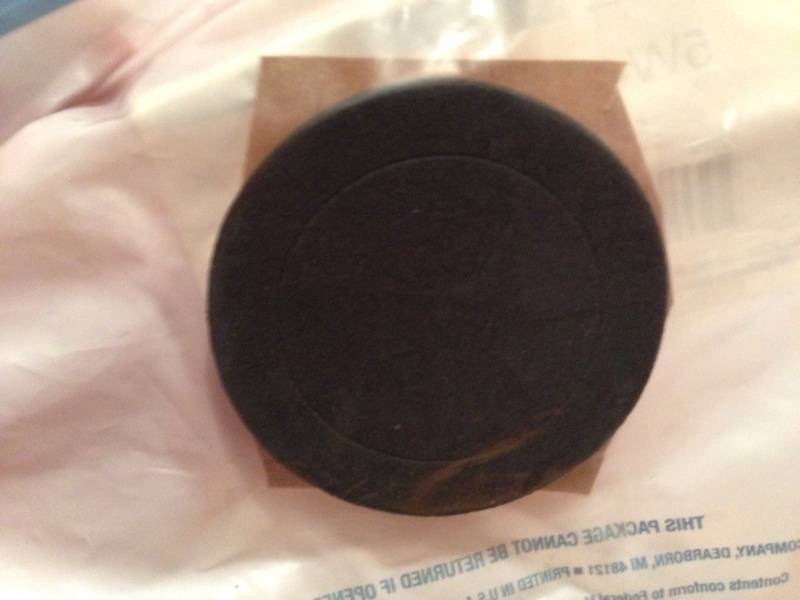

I have water leaking on to the back of my engine from the passenger side of the cowl. I searched and it said something about a foam seal. What does that look like? I know i can order it from tasca or ford local. Just dont know what it may look like without ordering?

Purchased from fordpartsgiant. Around $5 plus shipping.
How does foam prevent water from leaking? :shifty: lol
I've had my seal for a few months just sitting around because I don't see how that little circle is going to fix anything. It seems moreso that it's by design.
I've had my seal for a few months just sitting around because I don't see how that little circle is going to fix anything. It seems more so that it's by design.
My thoughts exactly! Lol
Mine has been sitting for a couple of months as well lol I literally just took those pics, package sealed.

Looking at that picture i dont see how it will prevent the leaking. I noticed on my way back home from indianapolis. My car started show a misfire. When i got home let it sit. Few days later pulled my coils out and the two on the passenger side had water in them. When and got another set of coils and plugs and now the rain has returned. I have not changed the coils and plugs yet but i can see where the water leak is coming from.
Looks like that is for the wiper shaft of the passenger side. There's also a linear piece of foam that goes under the cowl trim on that side. The result is to channel the water that comes down the windshield to the proper drains instead of onto the back passenger side of the engine. You may not believe that this works, but it does.
