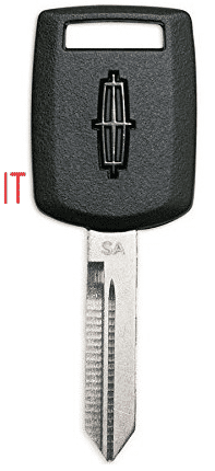

$80 for the key seems awfully expensive I know the local ford dealer in my town charges $35 for the OEM key for the Gen 1. Does the key look exactly the same as your old one or does it look like it's a newer style? The reason I ask is I wonder if they sold you a Gen 2 Key which will not work on the Gen 1.
looks exactly the same. what does a gen 2 look like?
