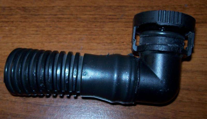

Installing K&N Typhoon today and have a problem. Apart from ending up with a few extra parts (I guess the T-Bird compartments differ after all) I'm stuck with a hose problem. In the instructions it says this vacuum line is rubber. It ain't. It's plastic. And it won't separate from the nozzle I need to install onto the NEW actual rubber hose. Here's a pic. I've already busted the hose trying to get this bit off with no luck and have cut my hands a good 4 times. Any tips?

But still, the MAIN inquiry was how to fix that hose. :)
I would think there are just push type plastic connectors holding it in place. Not sure what to say on the hose issue.
Got the hose issue fixed. :)
I just cut the plastic hose off up to the tip of the connection and put the new rubber hose over the old plastic one. It's a snug fit but pretty air tight, and that's what matters!

As far as the hose goes, I believe you should use an emissions rated hose because the heat and oil from the valve cover area may cause a normal rubber hose to fail eventually.
The hose is included with the kit and designed to be used with it.

But about the hose, I used the hose that came in the kit. I'm sure it should be fine.

At work, did a quick read and not sure if your hose question got answered.
I ran into the same problem. I tried ti slip the elbow of the hose and its nearly impossible. I used a hacksaw and scribed a diagonal line across the hose that's over the elbow. Got down into it pretty good until I began reaching the elbow. I then used a flat head screw driver and split the plastic hose by inserting it into the scribe and turning it. Either way, you'll end up spliting the hose.
That's what I did. Not sure how else it can be done.

And ya, the hose issue was solved as well, I just cut the plastic tubing as far up to the elbow as I could and put the rubber hose over the end of the elbow with an extra snug fit due to there being an extra layer of tubing. But the rubber hose did fit and it's airtight. So all good there.
