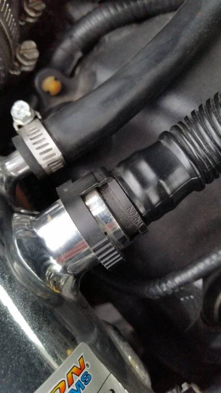

Hi Guys,
Attempted to install the K&N CAI and ran into a problem. Trying to re-attach plastic hose and it will not connect ( see picture). I first tried it with it on the car and then took it back off to have more room and it will not connect. Maybe there is some magic that I am missing to get it to reconnect. Any help would be appreciated.

IIRC as it's been a while, that hose doesn't snap-in the nipple as it does in the stock tube. I think that's just a vent tube anyway and there's no vacuum or pressure in that tube. If you don't have directions the K&N website has them as a pdf.

Steps #24-25 in Loud's instruction post. You need to separate the oem hose, and slide the supplied hose from the kit over the barb of the oem fitting.
If your kit was used and that piece was missing, you will have to find a proper replacement. Make sure it is heat/oil friendly material.

Looks like their picture shows a straightened oem hose, yours is still bent, have you tried re-forming it?
It barely connects and any slight movement disconnects it. I tried straightening it but still won't connect. The opening just isn't big enough. Spoke with K&N and sent them a bunch of pictures and waiting to hear back.

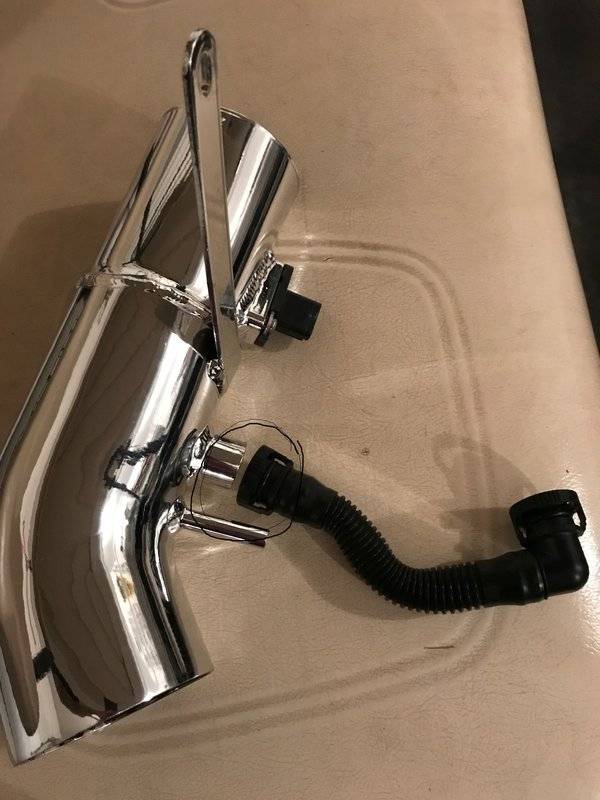

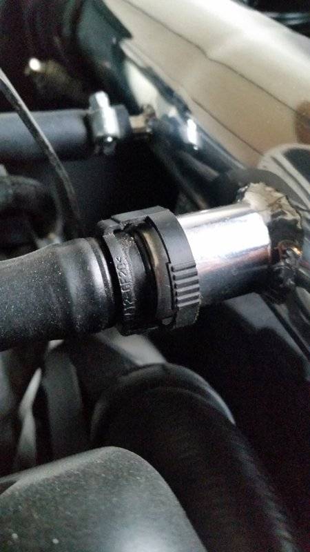

The outer plastic clasping ring fits overtop on the outside, (and really does nothing when fitted).
The inner plastic tube goes directly into the inside of the K&N pipe.
Line it up and push it all the way in.
Same deal as my 1st GEN ASMI intake.
Same plastic hose. It just fits inside.
