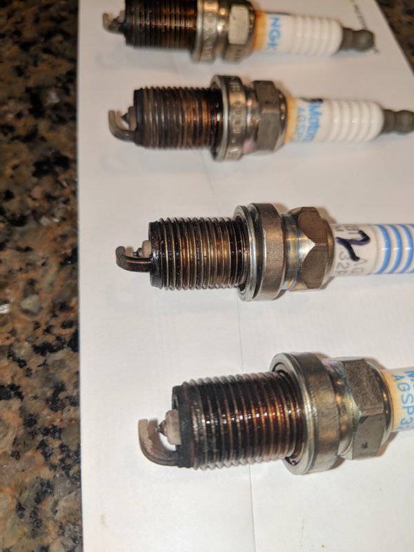

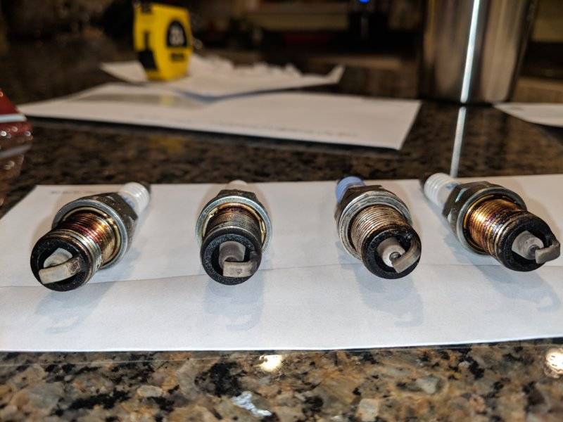

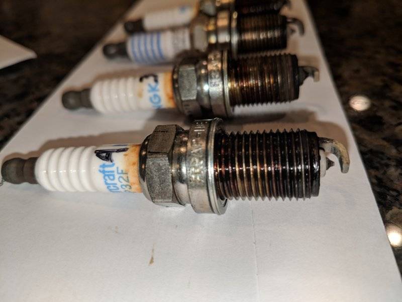

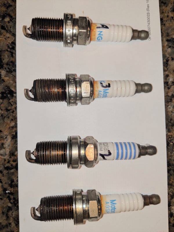

Pulled the RH side plugs and attached a photo. 54K miles on a v8. Threads wet and carbon around the plug base. I see a lot of carbon on the top of the pistons. Can I soak them with something that will dissolve some of that build up? Valves got to be covered too. Will start with Techroline in the tank as Joegr said.
Have about 1/2 teaspoon of oil in three wells. Boots are completely dry. I know this won't get better and it needs done but is this premature at this mileage or is an age thing? Is seal conditioner as an oil additive a nono? Also, assume I leave the plugs in if changing the VCG's to keep debris out of cylinders?
Also, gaskets are non rtv right? Nobody putting anything on them except as called for in two spots, correct?

Thanks guys for the info. I asked about the small o rings because it didn't call for them in the manual procedure but I get it.
I just pulled the driver side plugs. No oil. Pass side has light oil in three wells. Guess I could do that side and it's easier.
What do you guys think about the carbon build up I can see on those pistons? I'll search and see if anyone has brought it up.
...What do you guys think about the carbon build up I can see on those pistons? I'll search and see if anyone has brought it up.
What octane have you been using?
You could try a double dose of Techron to try and clean it.
Car is new to me (hence all the repairs I'm doing and my new membership). Owner she said always used premium unless it's crazy expensive... maybe that means 89 octane?? I know carbon is a concern in any combustion engine. I just happen to notice a good deal as I pulled the plugs. Wish I had a camera.
When I pulled the head on my Jeep, I had a chance to see carbon after 140k miles. Felt so good doing a head and valve job and cleaning the top of the pistons. Pulling the oil pan, the bottom end was really clean due to frequent oil changes.
I can run some product through the LS that hopefully will aid the injectors and some of the carbon prone build up areas. I just wondered if there was a product I could apply while the plugs are out. May BG stuff.
