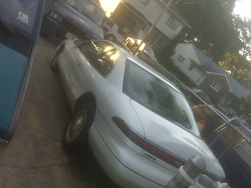

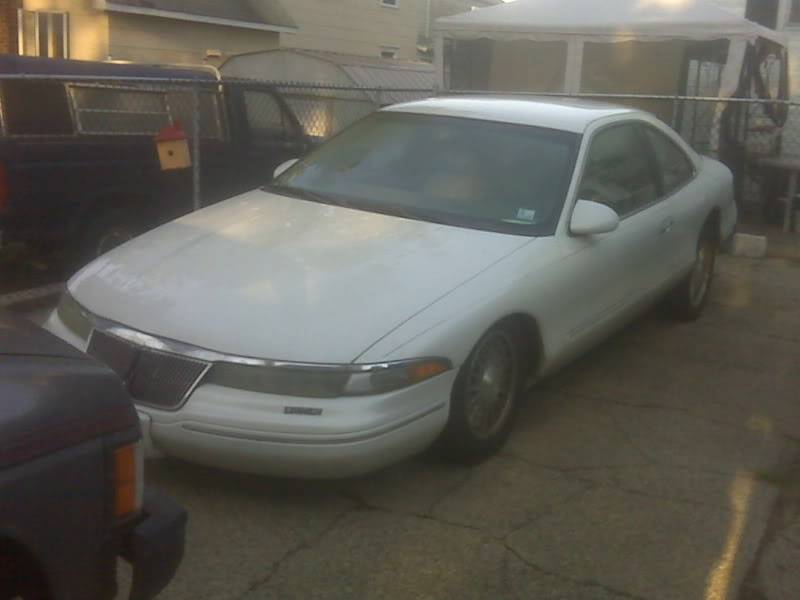

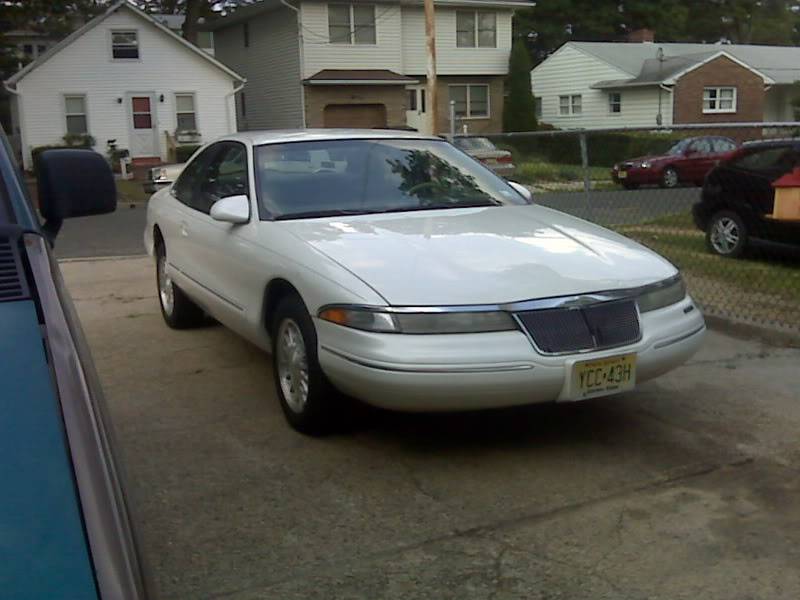

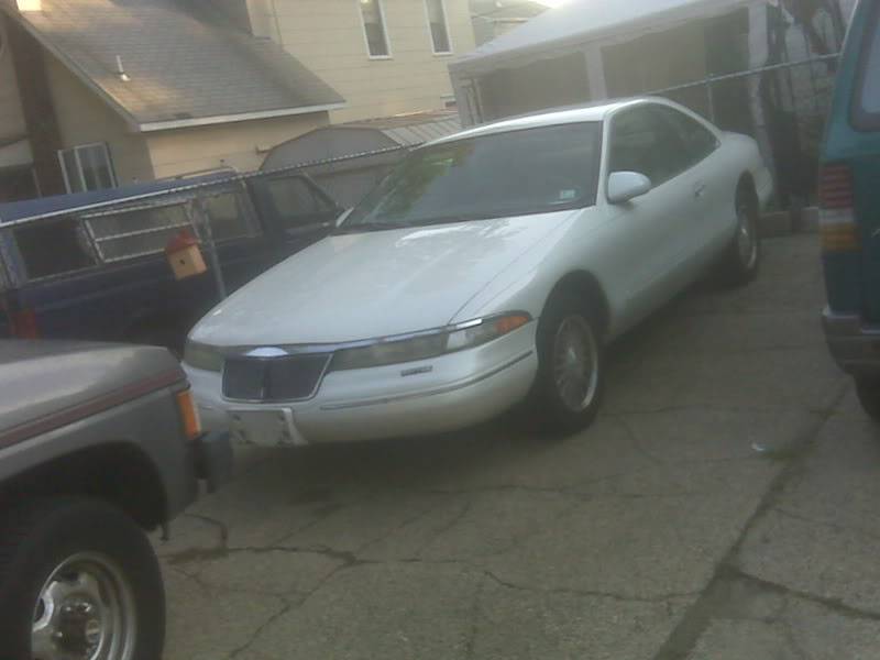

my friend needed to get rid of it because of parking reasons and had to many cars, its 1993 with 113k miles. paid $500 yes five hundred =). Runs great just one problem is when it sits over night the front slams to the ground, i'm doing my own reseach to figure out what it is, and after a minute or so check air ride warning, eh no biggie... just wanted to intro myself heres some pics
<--- freshly washed
Looks like a really nice car but your gonna hate the next part i am going to tell you. You have an air bag leak. If you want to replace it with air bags again, It will cost you 350 in parts. Or you can go for coils and forget about the air bags for life
