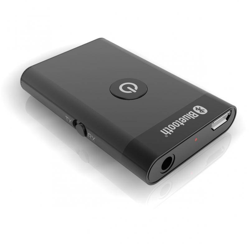

is it possible to add bluetooth to the 6 disk factory radio that works on all speakers? i dont mind front speakers only for phone calls but when i want to use the bluetooth for music, i want all my speakers to work. not sure if i want to give up the factory look for the stereo in the dash.
In theory, it seems like an easy concept to have a bluetooth unit that would feed signal thru an aux or cd player aux input, but i am not sure if they make that, nor do i remmber what the back of my radio looked like to remember if it had aux ports of some kind lol

well kinda, Isimple makes some hardwired FM modulator systems that work with bluetooth for audio and hands free that will work with every radio.
dont really like how unintegrated it is it terms of how it functions. for instance, say you listing to pandora on your phone, then a phone call comes in, all you have to do to answer it is hit a little button on the dash. BUT say your listing to a CD when a call comes in, you then need to switch the source over to radio, then hit the correct preset (if it's not on the right channel) and then hit a button on the dash. so there is a lot of inconsistencies that can be a pain when driving
there is just really no contest to how well and easy a good aftermarket radio will function with bluetooth integrated right in, and there are plenty of units that look just as well as the OEM nav system in the dash. all the lights color matched to the dash, factory SW controls working. more than a few people would think the car came with it.
Using a PIE adapter to provide the AUX input (stock 6 disk changer), I have one of THESE and it works great for Bluetooth Stereo streaming (and does play through all speakers on my setup.)
Side Note: I just read some of the reviews and I can say that I have had zero issues in the 13mo since I bought it, which was just to "hold me over" until I talked myself into an AppRadio. To date, I still have not replaced the deck.
