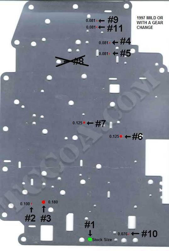

I just bought 2 used 1997 Transmissions from a member on here(Jamie) and i am about to begin to JMOD one of them and just wanted to double check with you guys and make sure i have all the drill specs correct before i go about doing this. I will also be doin the 1-2 accumulator and springs. If you have any input, please feel free to voice it.
Hopefully this will also help others who will want to Jmod there transmission sooner or later
