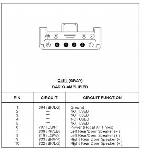

C451 is to the front/rear woofers (right and left front+rear woofers are tied together)

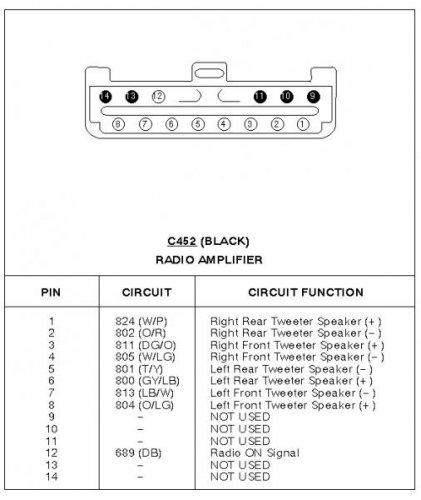

C452 is for the front and rear tweeters (each tweeter is separate channel)

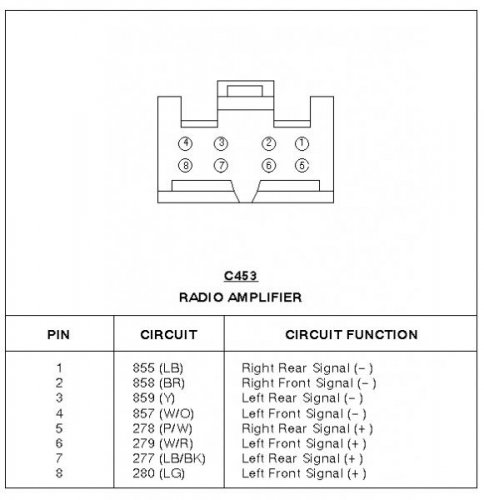

C453 is the input from the radio.
