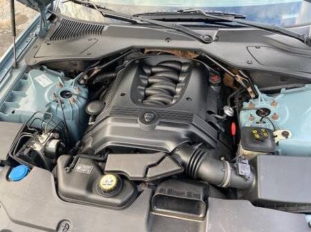

Now I know there was a fair amount of shared technology between the LS and the Jaguar S-Type but how about with the XJ8? I'm not looking to swap parts or anything, just curious. There is a really nice XJ8 sitting on the local car lot here in town and just got me wondering if Ford shared anything between these two vehicles.
Here is the engine bay:

Now your picture shows the weak spot of that car!
Note the red circles. That car still has the factory 4 wheel air suspension. It is troublesome and failure prone especially at this late date. So much so that the recommendation is to replace it with springs. There is a kit out that makes that swap easy and includes a special electronic module to shutoff the dashboard trouble lights you will get if you just disconnect everything.
The air compressor and front struts are the first things to go. You can struggle and replace those but it's all very expensive and will probably give you more trouble later on. The good thing is you can't tell much difference between the air suspension and the springs unless you drive them back to back. The air is smoother and springs really can't compare but almost every other car on the road uses springs so we are all use to how those feel.

That car looks clean but the XJ is all Aluminum so it won't rust but salt can still cause corrosion so take a look underneath. From the engine compartment picture that one looks like it's from a non-salt area?
