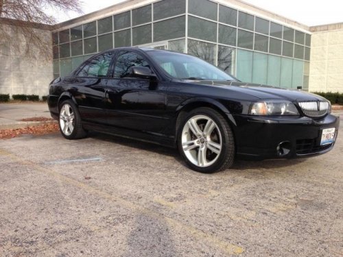

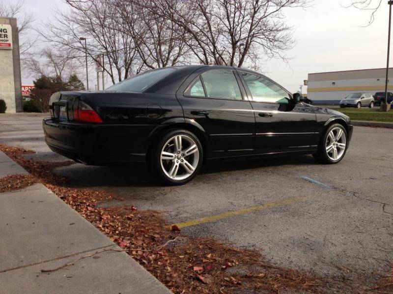

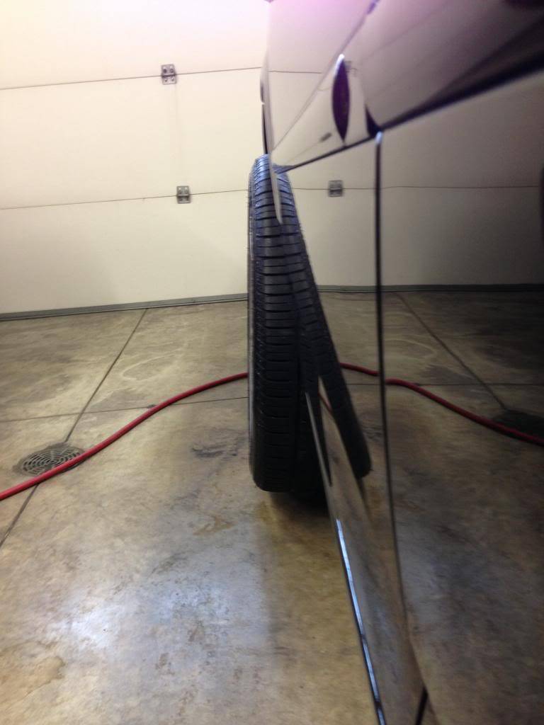

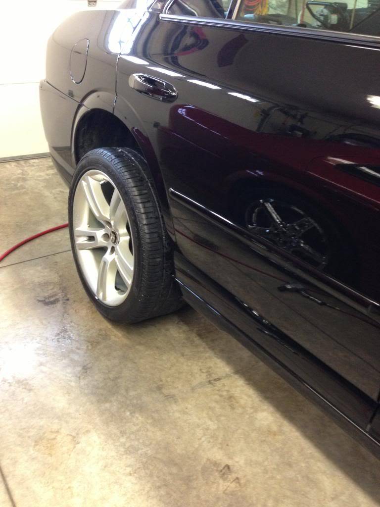

Thats an excellent price but the fitment is not ideal. The rear offset is 31. They fit the calipers fine, the issue is the stick out really far. I know because I bought a set of these just to see how the looked. Ideally you'd want 4 fronts because the front offset is 49.
Here are some pics of the rears on my old car, but i wish i would have taken the car off the jack so you could really see how far the stick out when the car was on the ground. The specs are 19x9.5 with a 31mm offset.

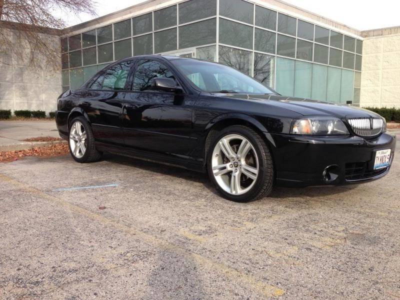

oh and here is how they look when you install the fronts (49mm offset) on the front and back. (you'd need 4 fronts for this look)
