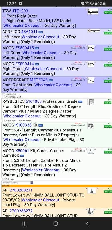

Rockauto wholesale closeout

I did not know about wholesale closeout. That's a great resource.
I got excited there for a second...but I do not see anything for the rear. Am I missing it?
Thanks!
