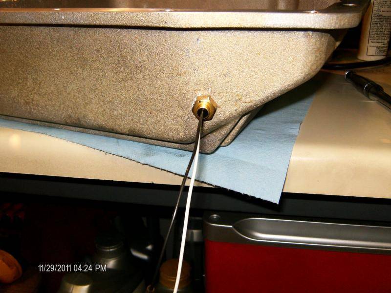

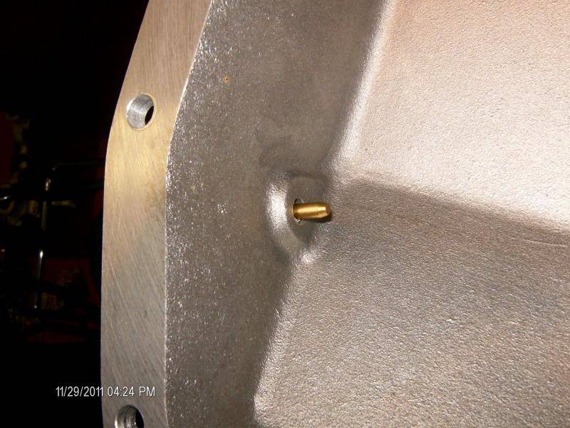

Decided to finally do a J-Mod and install a temp sensor in my LPW pan.

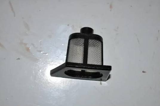

After looking for it a bit, I did some research and found that '98 4R70W's don't have the screen (1st pic) that the earlier transmissions had.

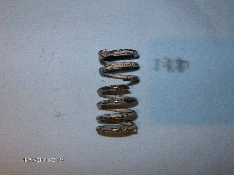

Discovered that the lower 1/2 spring was broken in half (2nd pic), which probably accounts for the rather harsh low speed 1/2 shifts the car has had since I got it. :rolleyes:

I need to change the accum. spring in my TBird. It slams into 2nd gear too. :( It was fun when I would make the wheels screech at WOT into 2nd, but the clutches have probably worn out and no longer does it.

DLF, did some research or some of the tranny gurus on TCCoA tell you about the screen? I guess that IS research, in a way ;)
