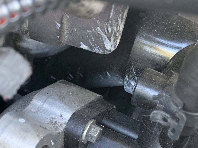

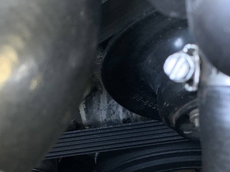

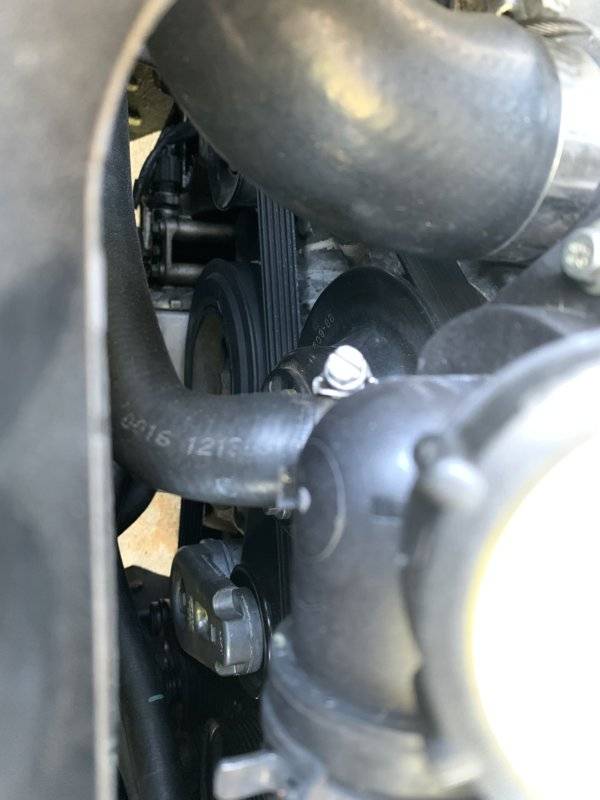

Was checking the oil and saw this (coolant splatters) on the EGR. It appears to be all down the front cover and I’m losing coolant.
All of the plastic coolant parts are Motorcraft and have been replaced in the past 6 - 9 months. I replaced the water pump about 18 months ago with a Duralast from Autozone because I couldn’t wait for a Motorcraft.
I am checking on the “Lifetime limited” warranty with the Duralast.
I can’t think of another leak location that would have those types of stains.

I can (crossover tube), but you are almost certainly correct that this is the water pump.
I used to think that rebuilt or aftermarket water pumps were fine. Maybe they used to be? Anyway my experience with my 2001 Ranger (a commonish, simple water pump) taught me otherwise. I'll never touch one again. Go get the Ford/Jaguar pump. Even if they send the replacement aftermarket pump with $100, don't touch it. Uber till the correct pump gets to you if you have to.
Thanks Joe...Normally, I think the crossover pipe could be the culprit, but with that piece being only a few months old and Motorcraft...
