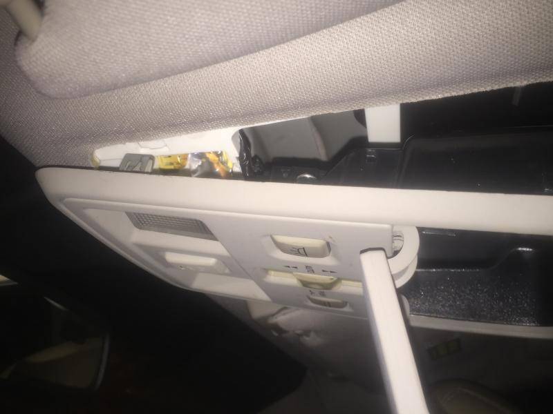

2006 LS, doing the led conversion and and finding it top be a bit of a pain. I'm doing the dome lights. I've spent lots of time reading everything that's been posted here and deemed that removing the sun visors and pulling down the headliner was not necessary based on other people's results. I dropped the overhead unit front and back, but it only drops a little bit as there is no slack on the wiring. Doesn't leave room to get at the bulbs. I pried loos the wiring for the sunroof control but that doesn't drop the overhead unit any further. I'm assuming the wiring for the lights has to be pulled, but theres no room for a hand to do that either, and how would I ever get it connected again?
when I did mine, some of the wire was caught up in the glue up in the headliner (I dont know if that is by design) but I was able to carefully pull it loose and get enough slack to get at the bulbs.

So I ended up sticking my cell phone alll up in that overhead area with the flash on and the camera running. I saw that The wiring was bundled up in some amber colored resin type stuff. I poked and snipped at it with a screwdriver and long needle nosed pliers until I removed enough to give the wiring a good pull and free it up and get some slack. After that I was able to get them bulbs changed.
LOL you know what? I hadn't looked at the lights again since I made this thread and forgot about you saying that. I had it in the back of my mind, but for some reason I was thinking tape instead of glue. Probablu because there was tape keeping part of the back seat light assembly from being pulled down when I did them. Thanks Loud!
