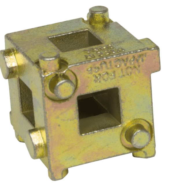

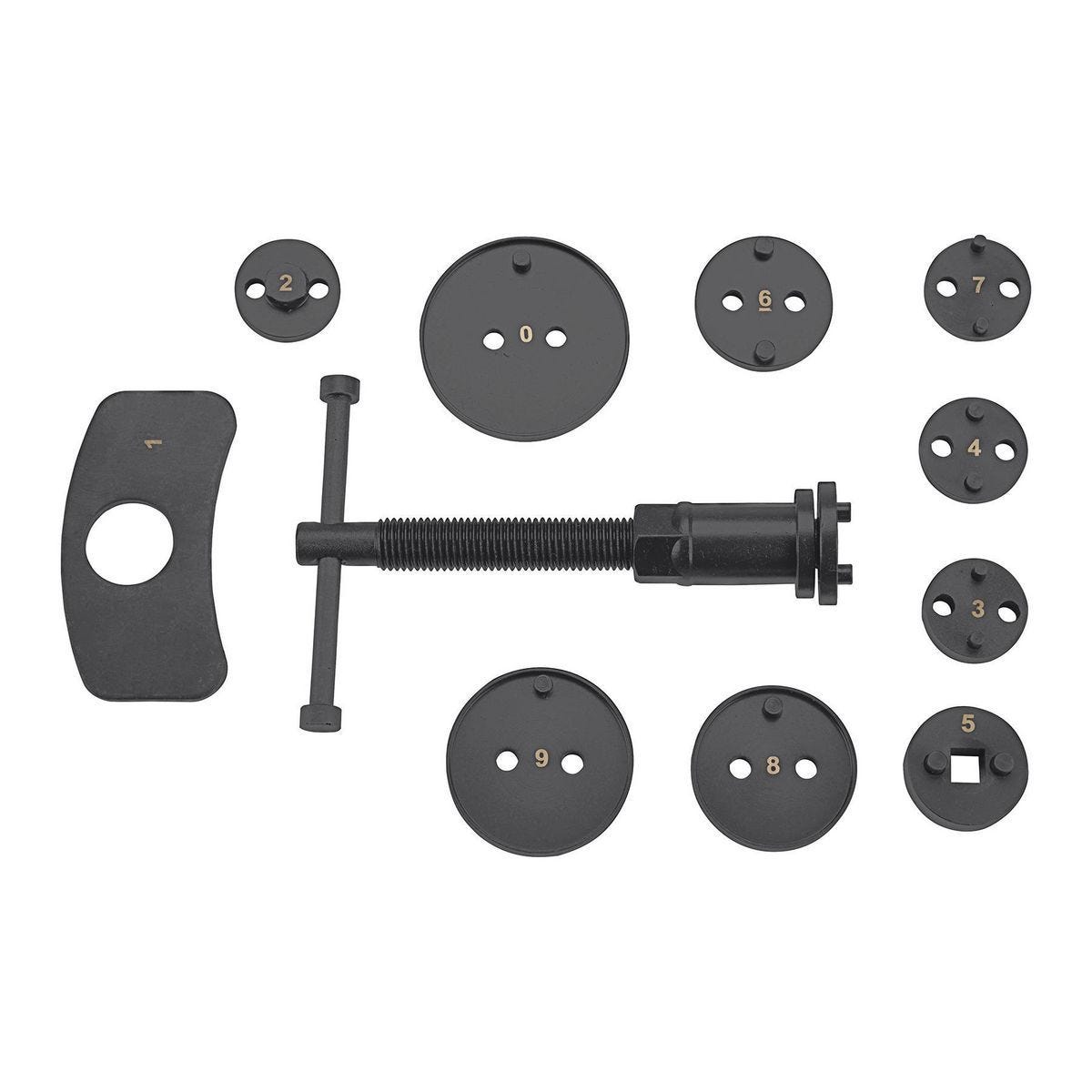

Yes I also have the Harbor Freight brake kit. It's surprisingly good quality. I had the cube first and always struggled using it but I will say I did a bunch of brake jobs with it but it was fiddly every time I used it.
Now it's almost a pleasure to spin the caliper pistons back in!
