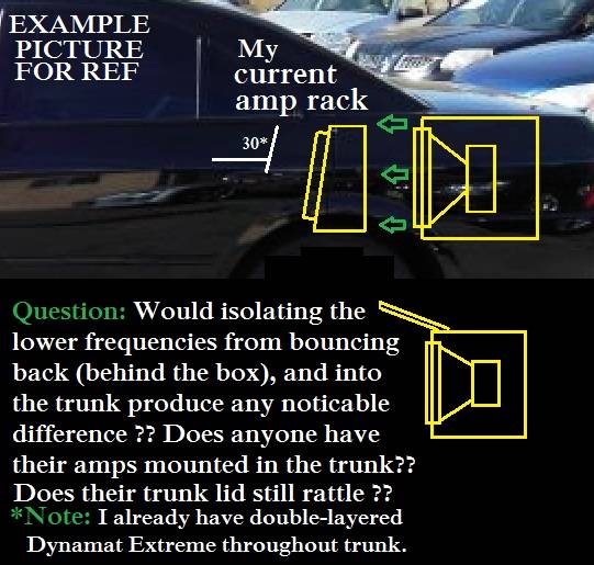

Would "partitioning","isolating" or "seperating" the Sub's frequencies from
"bouncing" or "reverbing" back into the trunk (and behind the box) make any
difference in noticeable sound ?? and or produce less (or remove entirely) the
rattle from the trunk lid ??
*See example below...(Side View)...

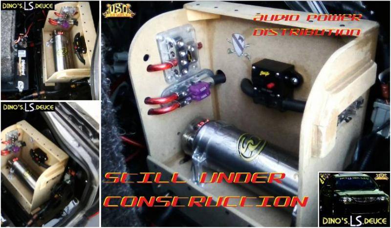

...STILL UNDER CONSTRUCTION... Double Dynamat Xtreme throughout trunk...
My amp rack is same thinkness as my audio's power distribution (1/4" mdf) and
there is currently more then enough room for the bass to pass through either
the sides or the top of the (2 amp) rack. I would just like a "cleaner look" and
would like to know if partitioning the front of sub box with 1/2' or 3/4' mdf will
give me better bass reproduction and less exterior rattle ?? I'd really like to
hear any "relevant" input and info. cuz, I really need to stop B.S'ing with this
overdue project of mine. I'm getting way too old to be messing w/ my stereo
over and over and over again... -THANKS ALL in advance...

If you don't want to deal with problems due to cancelation, there is basically three ways to do it.
1 have a normal sub box facing the back of the car (most rattle)
2 Having a free air set up (medium rattle)
3 having a box facing forward all the way toward the front of the car (and here's the hardest and most important part) having it completely sealed and isolated from the trunk area (almost no rattle)
Without properly sealing the cabin side with the subs away from the trunk area, I have never heard forward facing subs sound better than rear facing subs
