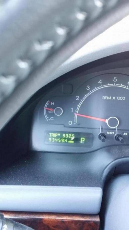

It's 103 outside and the temperature gauge wants to keep creeping above normal. Ac is on max and I can hear the radiator fan. Runs cooler on freeway, almost normal. Reserve tank is full. Picture was taken while idling after a 20 minute drive. Thoughts? Dealer wants 130$ just to look at it.
Yes, that is very much overheating. Overheating starts before the gauge even moves out of the center. (And, that's not a "reserve" tank.)
Just wait till you find out what they want to fix it...
The catch tank at the firewall was pretty low. Topped it off then tried to bleed the system. With the bleed screw removed it took a few seconds for the coolant to come out. It was a very small stream that hardly flowed. After 2 mins the stream was more consistent. Oh on a more good news bad news, the balancer is starting to fail. I was looking for leaks when I noticed the balancer not being true while it spun. Had a slight wobble to it.
