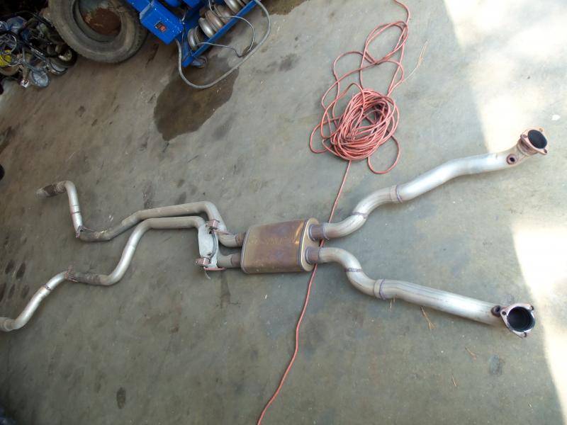

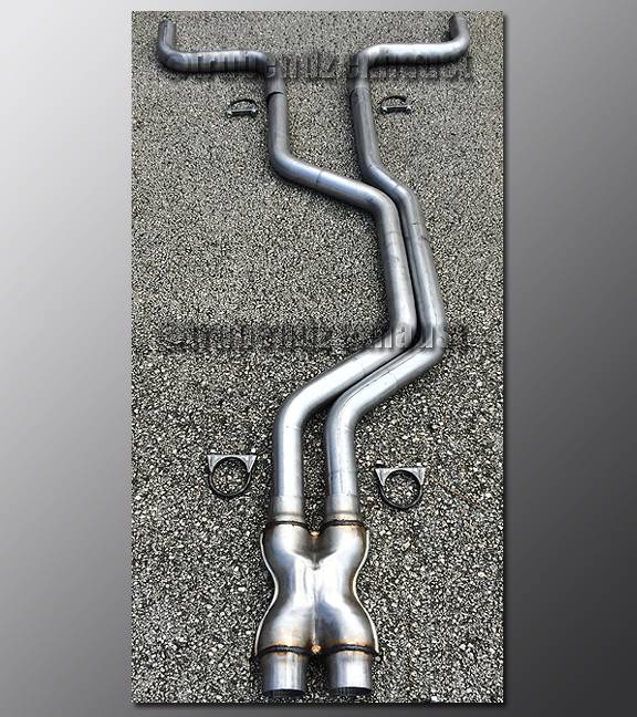

For the WF in the coming week I'm going to put a dual in/dual out(Borla, Magna or Dyno) in place of the stock H & 3rd cat and will add it to the mandrel bent system I bought again from TRUBENDZ.
The thing is I didn't realize until I received the package that they now include the crossover pipe that is very similar, if not the exact one, some of us have previously purchased from ebay and don't want to let it go unused. I've seen some of yous running 2 X-Pipes in the center and am thinking that maybe I can do the same but am unaware to the pros/cons of running Dual Xs.
Would it be a difficult fit being that the X from TRUBENDZ is shorter than the other DI/DOs?
How is the sound effected by running 2 X-pipes instead of a single X or single DI/DO?
What's the difference in that one is an X pipe the other is a Muffler?
You know, those kinds of things. Any and all input is appreciated!!!
