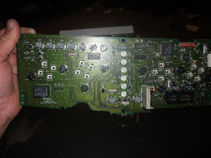

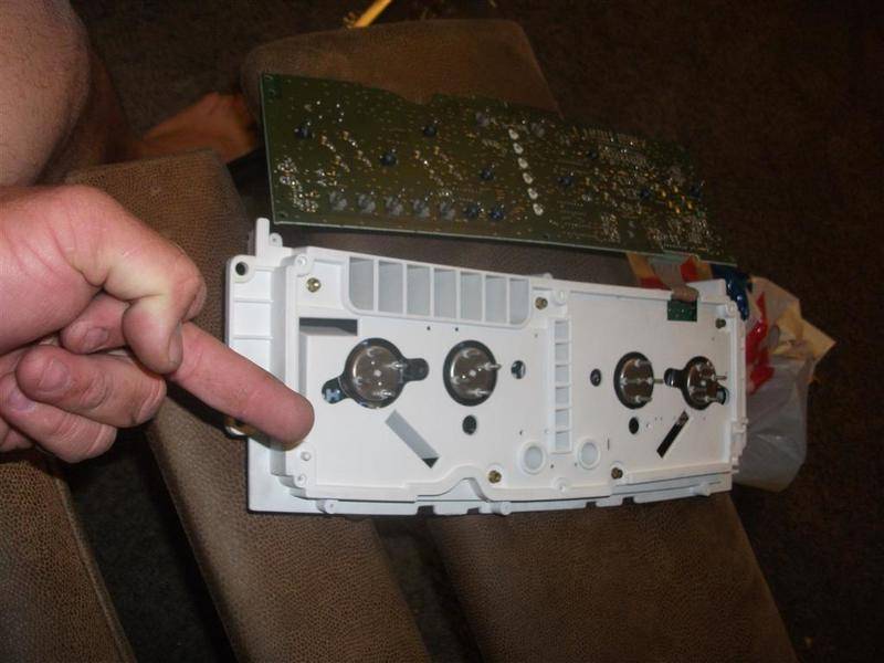

OK, here is what I had...excuse the middle finger please, I was not in a good mood that night
two boards, as you discuss. The main board that you see is the one that went out on my cluster. The ODO board as you discussed is inside the cluster right behind the gauge panel...
all I did is swap this large main board, and I left the original board with odo display in my cluster. The mileage crossed over with this large board, even though the smaller odo board remained...am I doing it wrong?
I kept all my original cluster, and just swapped this board pictured below. The mileage seems to actually be pictured on the circuit board below, and unfortunately that's what blew. In the end, I'm ok with it, but I had to ask of course just to see if I could do it
you can swap over the whole larger board thats fine too, i just thought you wanted to change only the little mileage screen board thats why i said it the way i did, but yes you can take the whole entire board from one cluster and swap it over without having to remove the actual mileage screen board.

the mileage screen board is not the unit that contains the miles...oddly enough. the larger board contains the memory for the miles, so in my case, swapping the mileage screen board won't work...that's ok though..at this point my entire seat is apart and non functional, so I've got to do something about seat tracks so I can even drive the car.
well you are not correct there. i just did this in my 97 lsc, i took a cluster i had plus the cluster that came with the car, the one that came with the car had white face gauges, i removed only the mileage display screen off the white face cluster, and swapped in the screen from another cluster and the mileage changed to the one i swapped in, so take that for what its worth. i did this last month so its fresh in my head.
