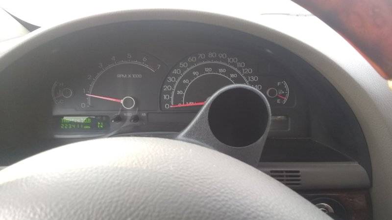

Thanks for the ideas FDR and rgorke. Truthfully, I'm looking for something a little more permanent... that could also be removed and installed in another vehicle when the LS goes "out to pasture".
Thus the idea of mounting a gauge pod on the steering column. I did this with a tach in my pre - LS panther body. I still have the gauge pod... and it fits the LS column, (with minor mods)... although there's a gaping hole for the column shift. I think one for a floor shift Mustang will work too, (with minor mods also).

More or less this:
Plus this:
Now it's time to paint. Since temps are dropping I'm gonna have to build a "hot box". No way I'm spraying that self etching primer in the house. That schitt is nasty.
