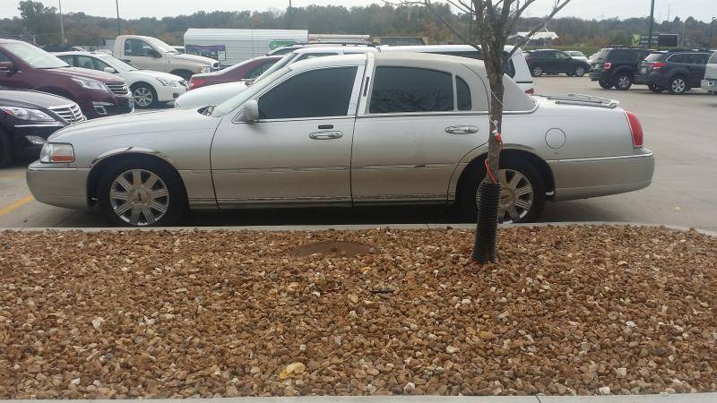

1. Does my car look low in the front? It had airbags in the rear but they were replaced with springs prior to me buying it. I've seen other townies same body style and some look similar in front height while others do appear to be higher. I've priced the quick struts and thought may as well press in new lower/upper ball joints and install link kits. Think its causing my tires to wear on the inside faster.
