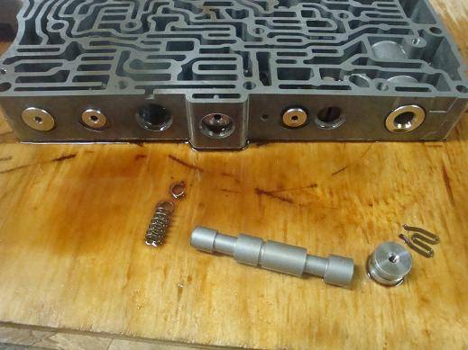

I just lost 5th gear, rest of the gears shift fine. code P0775. I have removed the valve body and solenoid block, will probably replace at least the solenoid block (maybe both). While I have it apart I would like to have a look at the bore in the overdrive servo. I really don't think the problem is there though, as this servo is also used on 2nd gear and it works fine. So has anyone ever attempted it?
'01 LS V8 5r55n BTW
