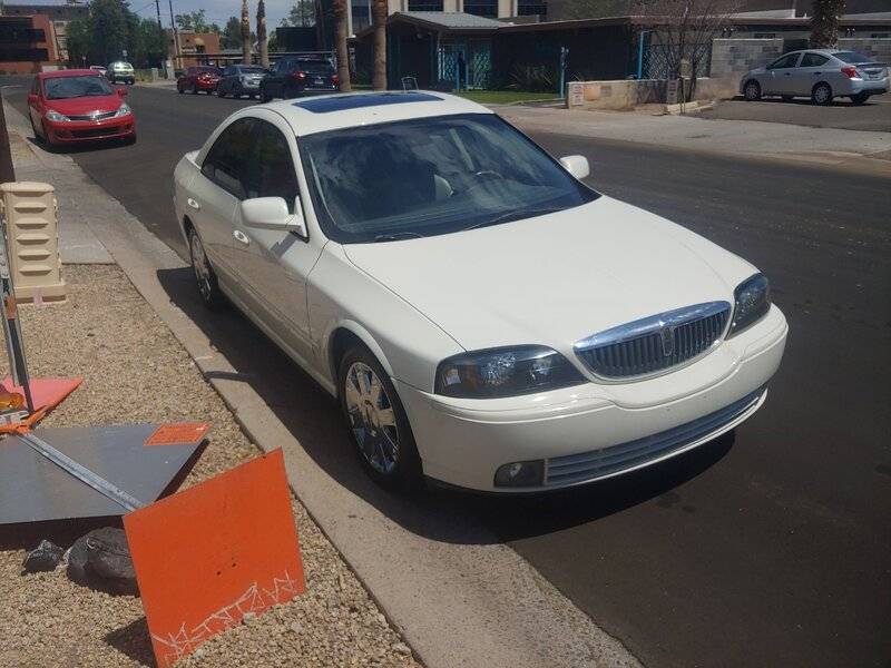

I just wanted to share a 2003 lincoln ls v8 purchased at the salvage auction to possibly help anyone with similar issues in the future. I am sure this topic has been discussed, however, I figured I would share my experience to possibly help anyone keeping these old beauties on the road.
Ever since I purchased the car, I started driving it after repairing body damage. I dealt with an intermittent starting issue, particularly after sitting in the hot Arizona sun for a few hours. Also, I noticed the transmission was sort of lazy and unresponsive at times. I would put the pedal to the metal, only to wait 2-3 seconds for a somewhat clunky downshift. Additionally, when shifting from 2-3, it felt like the transmission would sort of drop into third. It just felt like a worn transmission to me (only 105k on the car). I changed the fluid and both filters on the transmission to no avail. I had also been dealing with a very annoying intermittent crank issue. After doing some reading on the internet, I ended up deciding to replace the neutral safety switch (with the transmission cross member in place I might add). After replacing, all symptoms are gone. It feels like I dropped in a rebuilt transmission. Shifts are firm, no more 2-3 hard shift, and very responsive when I want to have a bit of fun. The fact that a 35 dollar part mounted externally could produce these symptoms baffles me. Also, the vehicle threw no codes whatsoever. Hopefully, this helps anyone with similar issues. Another LS saved from the crusher.
