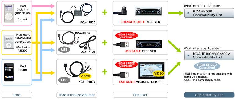

Again, if you look at the compatibility picture, you'll see that they only recommend the 100, 200, or old school IP500 for the ipod touch. the old school one may not work for you since you may not have the input for it.
Here's the pic. Follow the blue arrows. Also, I suggest trying a regular ipod on it to see what it does now.

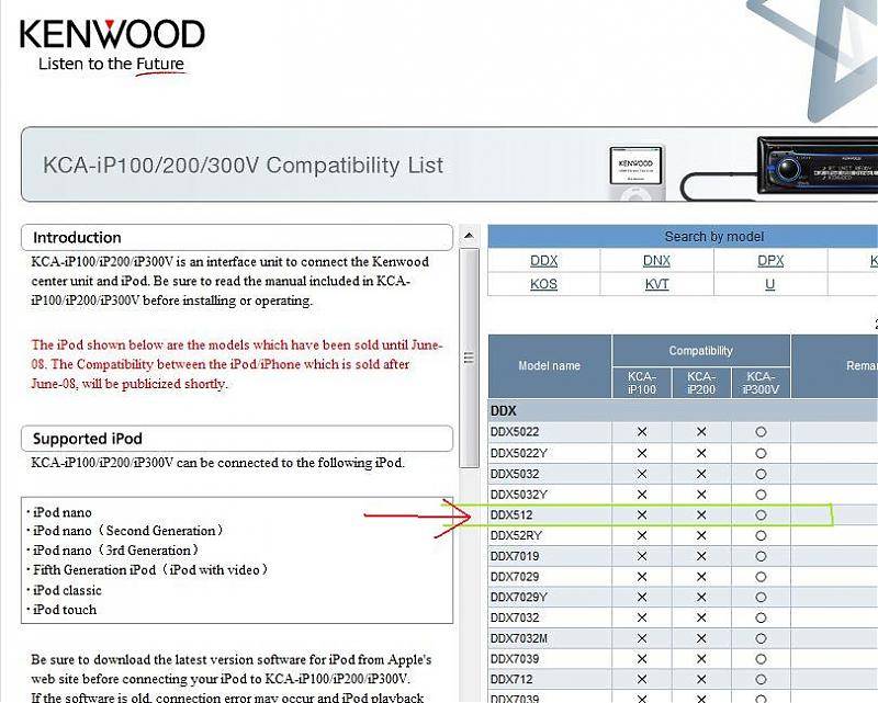

Sure they are. You won't get video playback either way with the ipod touch. So might as well go with the 100 or 200 cable.
This is a capture from kenwood's site showing cable compatibility:
