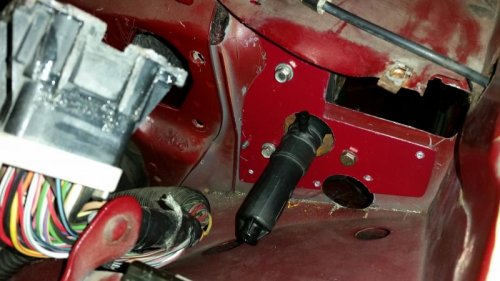

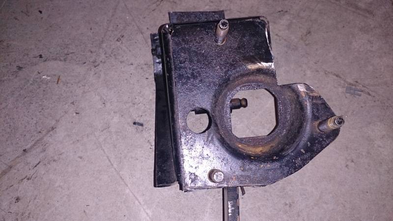

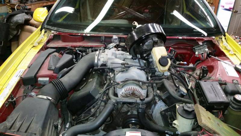

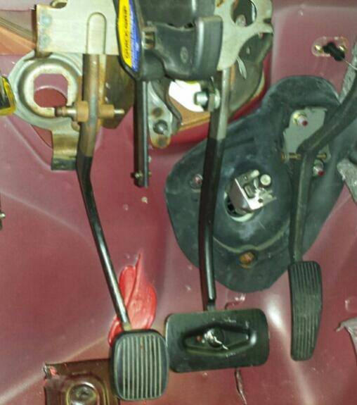

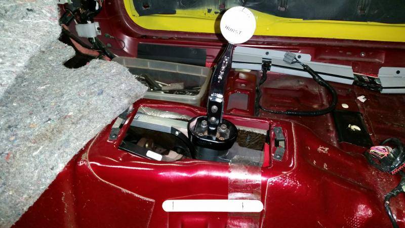

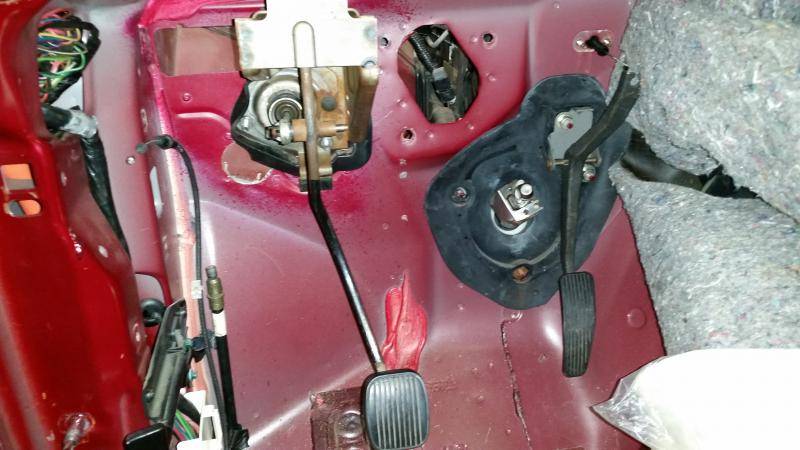

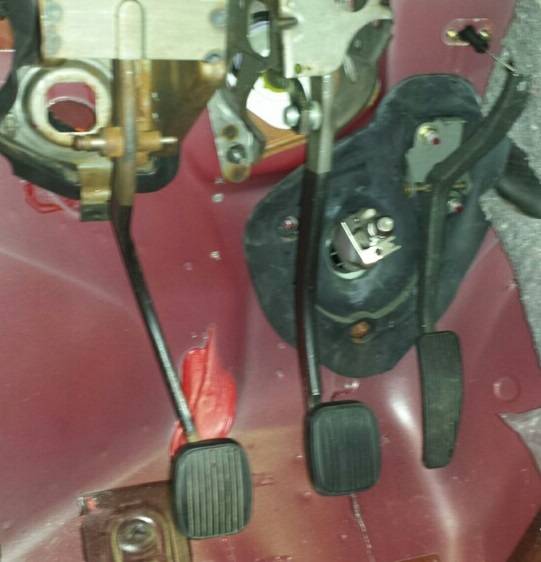

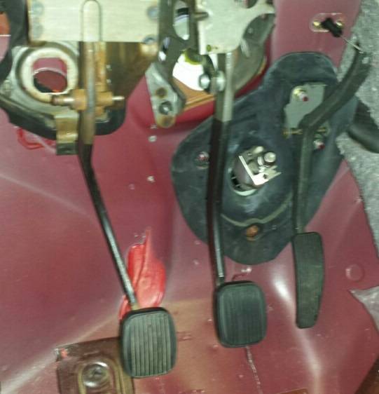

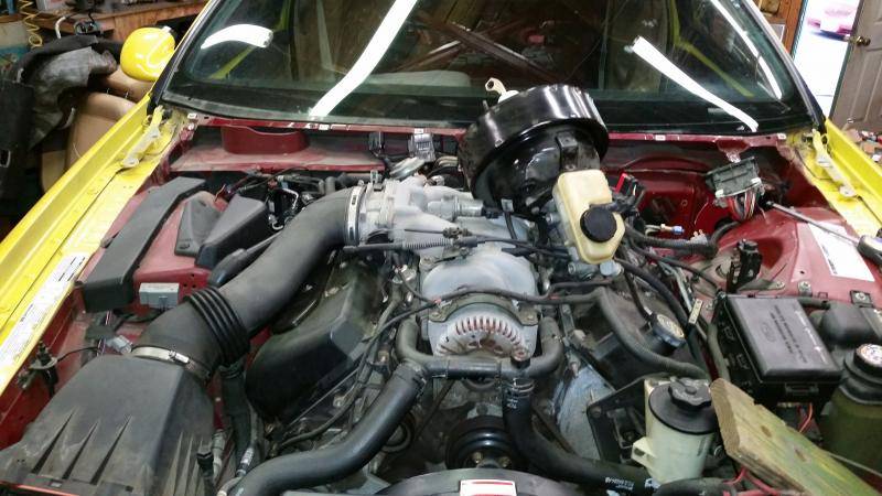

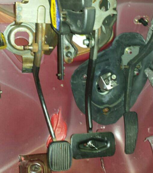

On vacation right now, but my dad sent a few pictures of the progressView attachment 828471951

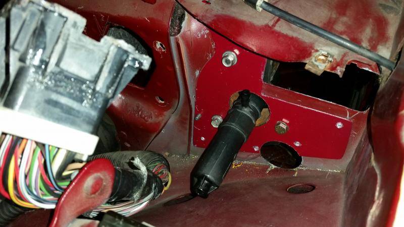

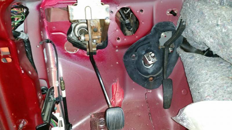

Ecu harness can fit under the clutch pedal mount with firewall mods.
The main harness also needs to be moved towards the fender.
It also helps to trim the clutch pedal mount
