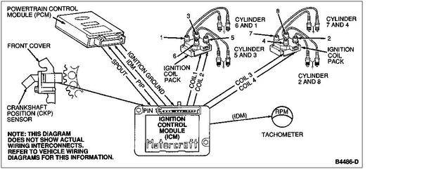

When it died on her she was driving in a 25 mph zone and probably goin like 30. And I'm airride free on this car so that wasn't the issue. The fan may have been runnin but now the damn thing won't die. I am having no luck recreating it. I got it to die yesterday and it lost spark when it died, not fuel. So i'm thinkin of throwing a csps at it for $20.00 and see what happens to her. The car has been running all morning drove it around out back left it in gear on the rack with the cruise set IT WON'T DIEEEEE AGHHHHHH!:mad:

If you lost spark when it died it was the crank sensor or harness connection to the crank sensor.
Thank you driller, to my best recollection the crankshaft pos sensor is the only thing that tells it to spark? this doesn't sound right as I say it. There is an ignition control mod right? Why amI asking this I'll just look at alldata.
Yes there is an ignition control module as well.. pull the cover off the drivers side strut under the hood and you'll see what is called the EDIS module
I beleive it stands for "electronic distributorless ignition system"
ICM...
