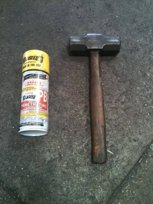

PB blaster... Once again...why don't you people use LUBRICANTS!
Squirt a bit on it, let it sit a few...then smack it with a hammer... I've NEVER had to destroy a rotor to remove it from the hub.
I remove at least 20-30 rotors a day in my shop...some from northern states, where the cooling fins are completely rusted closed, and I still don't break them
