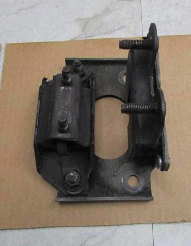

You need to retain old Lincoln bracket. If I recall correctly, Lincoln service num was a two piece part. Mustang had separate pns, or did not require a bracket.
Lincoln bracket & mount, F3LY-6058-A, pic attached for reference.

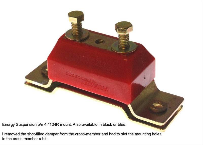

Aftermarket RearEngine-Transmission Mount, Energy suspension pn 4-1104-R. Also available in black or blue.
