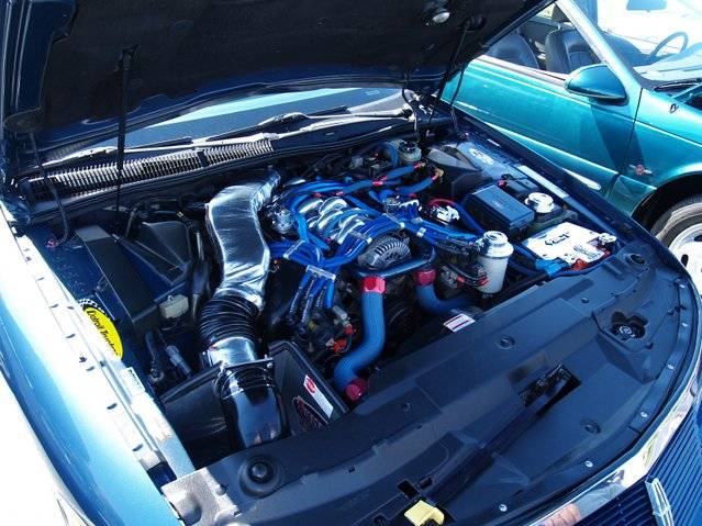

This is my Gen1 CAI setup...
Where did you get the heatshield? Did you fab that up? Also the metal intake piping, does that attatch directly to the mafs? Or is there a cone adapter underneath that?
I would like to have a similar setup so i dont have the whole home depot thing going on, but i think it works pretty well. im embarassed to take a picture.
mafs - mafs cone filter adatper, rubber sleeve, PVC 4" (PVC going over mafs adapter) elbow to 3" to a 9" Spectre filter in the fender.
I think it was Mespock who had a similar setup, but he used a rubber elbow, couldn't find that at my local home depot!
Years ago a company named DenseCharger manufactured CAI kits for 'Stangs, Tbirds and the likes. I bought a complete setup after talking to the owner. It's basically a hybrid between a Cobra and Tbird kit. The Cobra kit exited out the side of the fender and had another 90 degree elbow with the filter inside the fender. The T-bird setup exited out the bottom of the fender. The Pro-M MAF was calibrated for the 96-98 Cobra 4.6L and the second elbow was deleted from the kit and I think the MAF adapter was from the Tbird kit. The elbow and filter extension are PVC. The PVC elbow is flanged directly to the MAF. The other end of the MAF is directly connected to the stock rubber bellows type tube connector that used to connect to the stock filter box. The hole in the fender for the piping had to be enlarged - likely the hardest part of it all. Also this setup requires the suspension compressor to be lowered 1-1/2" to make room for the air filter.
Armed with the calibration numbers from the MAF, the tune on the chip was made to match, elbow and all. While one could argue the HP benefit of the MAF and all that, the CAI is very efficient. I moved the outside air temp sensor to the fenderwell right next to the intake filter and can monitor intake temps real time.
The heatshield was an original IceBox from LMS. I had to notch it to mate with the new plumbing. It helps shield the setup somewhat. The intake tube is simply wrapped in heat reflective material - ricer style. :D
