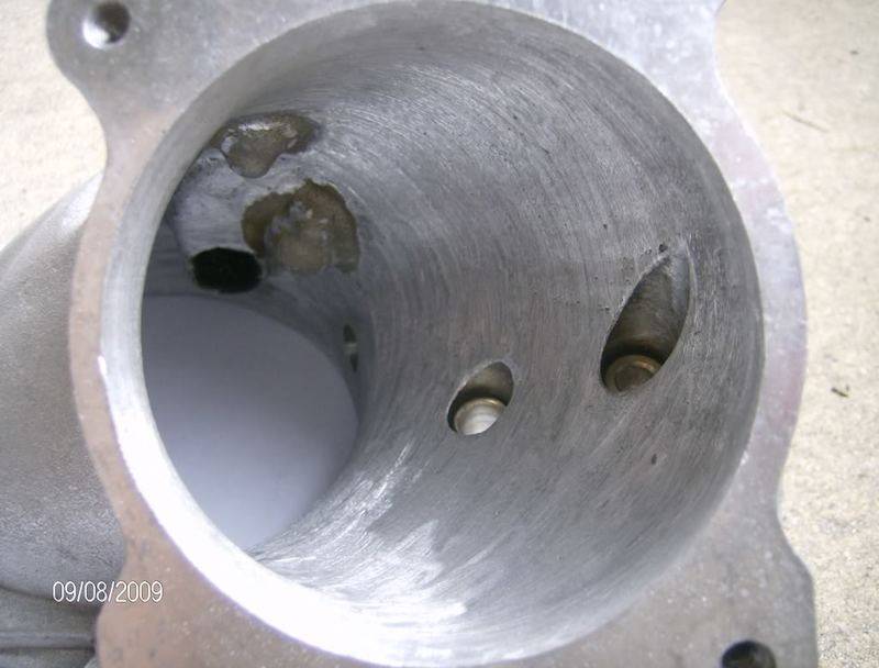

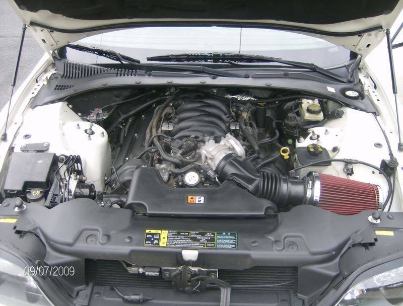

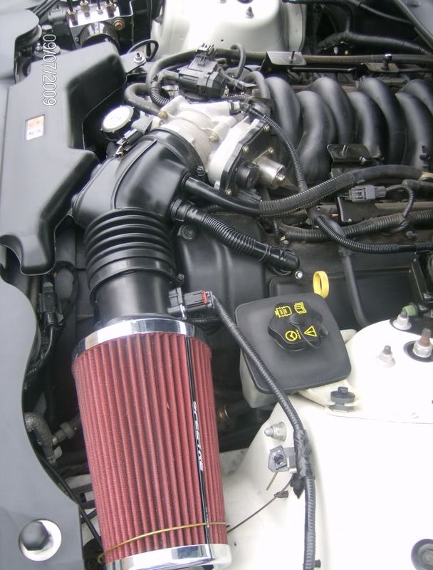

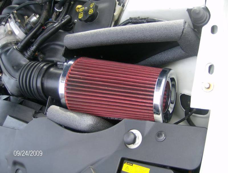

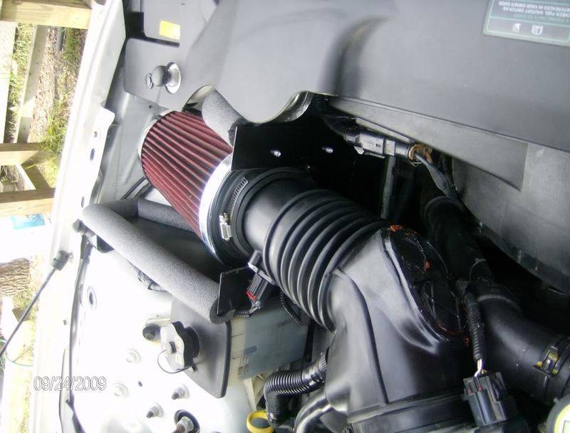

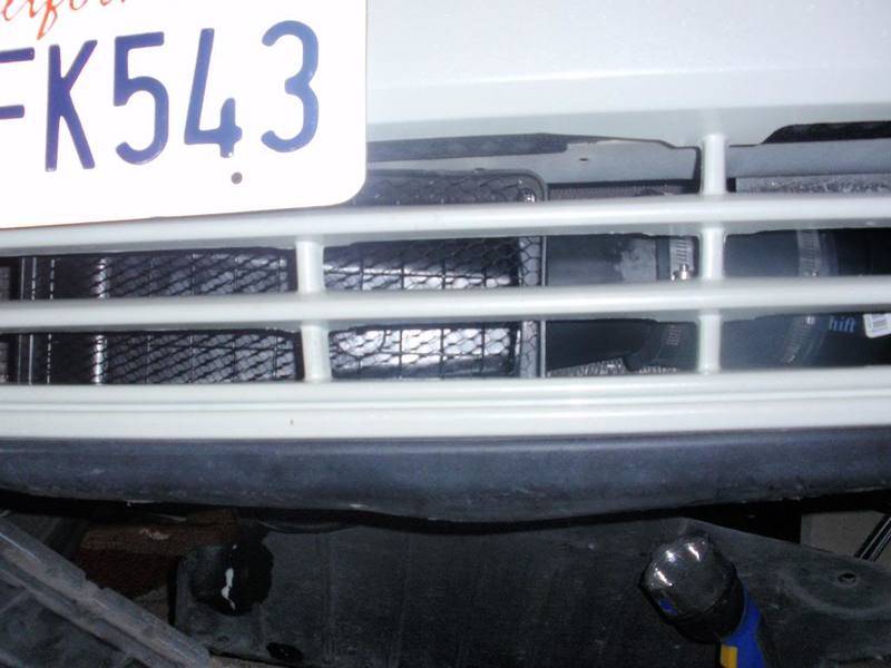

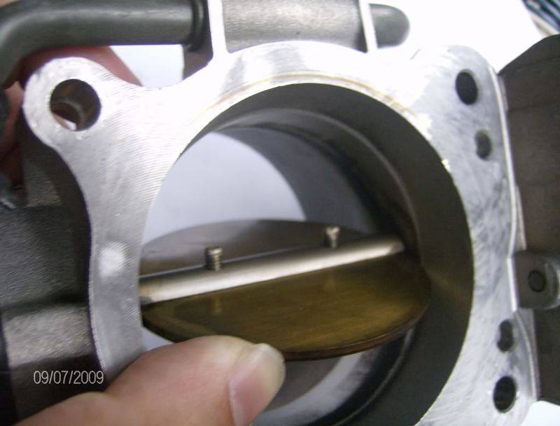

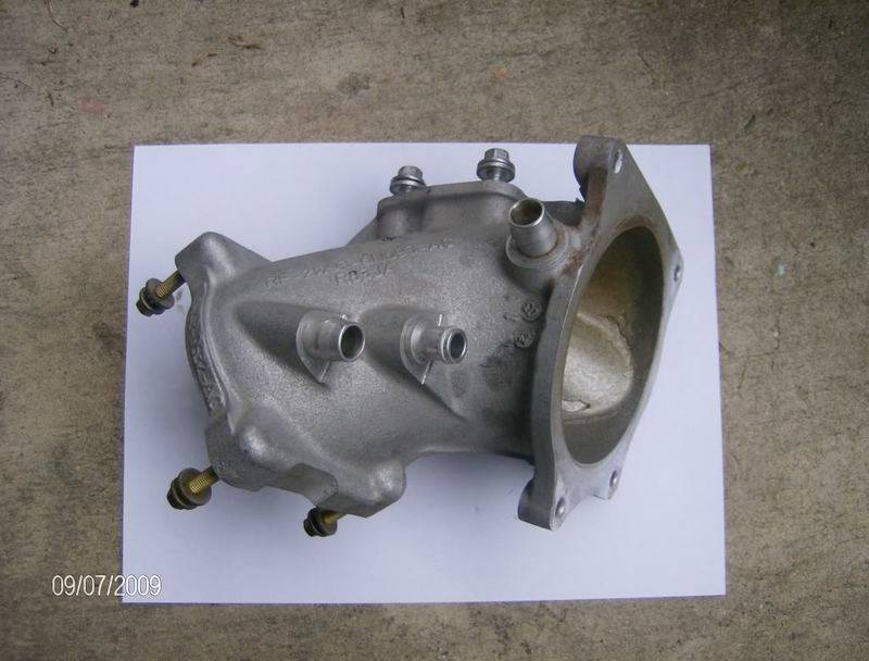

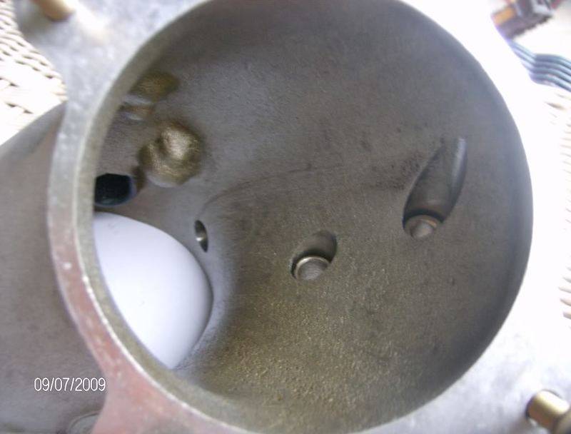

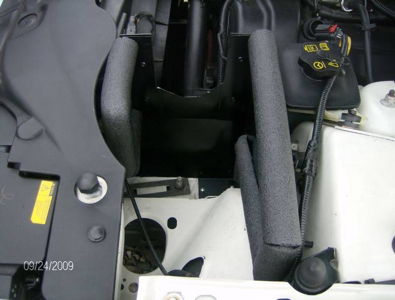

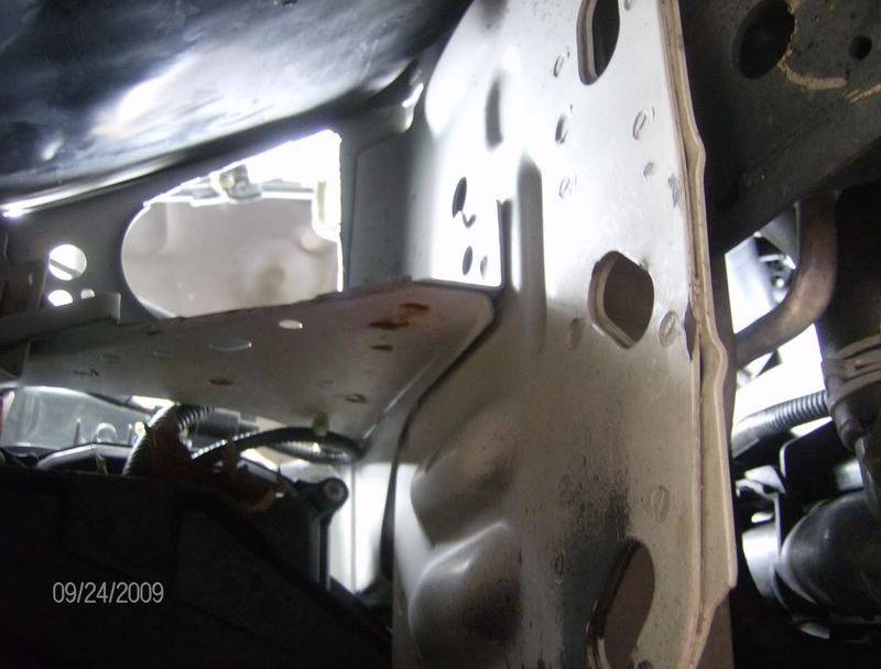

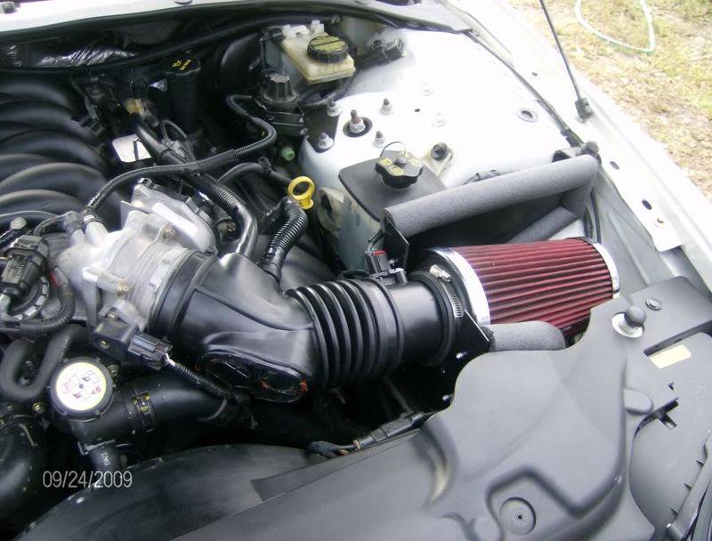

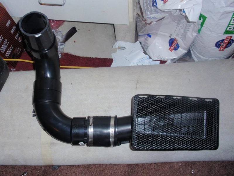

1)Just a cone filter, cut maf from air box. 2)pulled throttlebody and neck, polished neck and cut-off pertruding butterfly screws. 3)Cut off noise supressors. 4)made an air box and some ducting to direct fresh air to the box.

Nice. I stuck this in there. I used the stock air box to grab the air. Put a little mesh in there so bigger things did not go through.I put something in between the black pipe and the cone filter cause it was throwing air directly onto the air filter and it got it dirty where it hit it. There was a round, black spot where the air hit the cone. Now i just have a flap on the pipe so it brings cool air into the filter area but the dirt wont hit the filter.

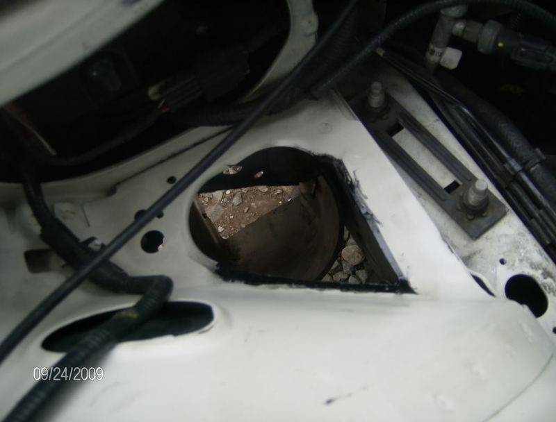

no offense but that's an ugly set up..you're gonna get all kinda of rocks and debris coming up under the hood. SHAME ON YOU

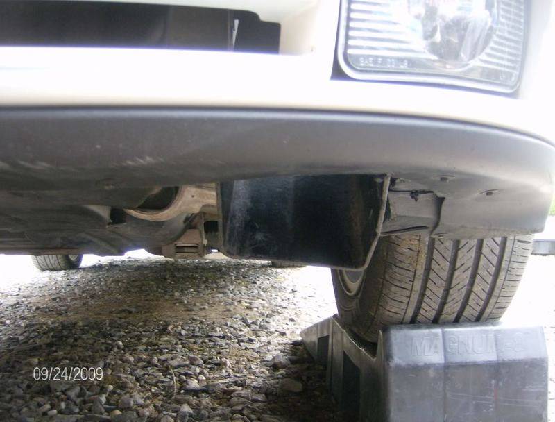

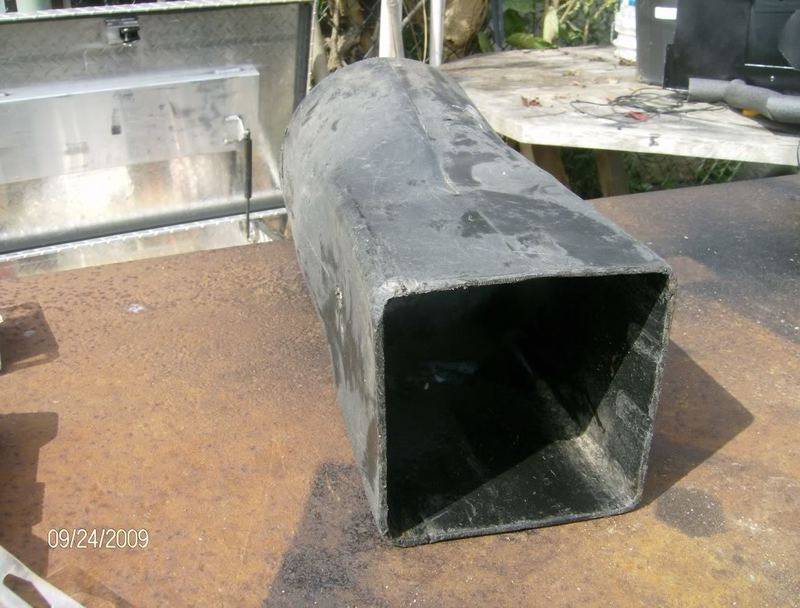

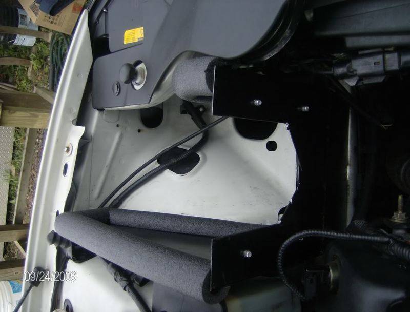

In terms of it being pretty - the ugly is under the car - could have paint it but why its under the car and its plastic and its exposed to the elements. What I was after was the biggest gulp of cold air possible. Eventually I will replace the intake tube with an aluminum piece(currently unemployeed). I spent $3 on foam insulation and the rest was scrap metal rivots and some enginuity
because of the combination of everything it makes a very noticeable difference especially at speed (40+) and very loud on throttle. If there is any lose it is overcome easily throught the combination
